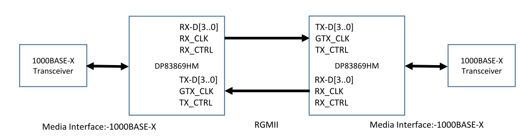

Part Number: DP83869HM
Hi all
Woudl you mind if we ask DP83869HM?
Is it possible to configure following using two DP83869HMs?
Kind regards,
Hirotaka Matsumoto

Hi Matsumoto-san,
Yes, this configuration is possible. Is this for a fiber repeater application?
-Regards
Aniruddha
Aniruddha
Thank you for your reply.
Yes, they use for 1000BASE-X. They intend to use for repeater application probably.
Kind regards,
Hirotaka Matsumoto
