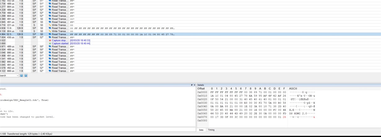

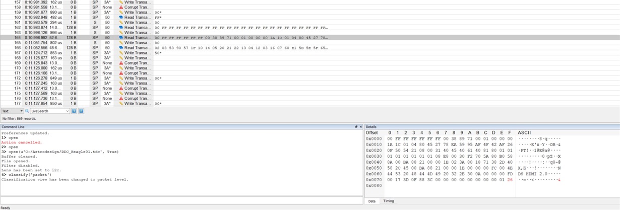

I have an issue with DP159 when setting DDC / HPD in snoop mode but no issue if DDC transits through active DDC block
1.  when DDC transits through active DDC block of DP159, HDMI 2.0 source (PC graphic card) signal in ON and I can see content on the display.  Read back TMDS clock ratio = 1/40
2.  when set DP159 as snoop on DDC interface, same HDMI 2.0 source shows no output and hence no content to display.  Read back TMDS clock ratio = 1/10
Note that either active DDC or snoop DDC works OK when source is HDMI 1.4b
What difference can it make when DDC transits through DP159?   Looking DDC traffic on the scope, there are more transactions when HDMI 2.0 source DDC info  transits through DP159 than being snoop by DP159.   Would it be the "true" sink of the HDMI 2.0 source and just conveys the info to the display?  And why there are less transactions in snoop mode leading to HDMI 2.0 source with no output?

  • Hello I.K.
    HDP works OK.  Above scope captures are the DDC_SDA line.   Top is when DDC interface goes through the DP159 ( source works OK and shows content to display) and bottom is when DDC interface is snooped by DP159  (source is off and no content to display).
    I do not understand why there is a difference in DDC traffic between both connections as I assume the DP159 would not alternate the DDC traffic content, regardless how it taps DDC traffic.  Is it a correct assumption?
    Again, this happens only when I use a PC graphic card to send HDMI 2.0 signal (4K 60Hz).  I do not have issue when I use same graphic card to send out HDMI 1.4b signal (4K 30 Hz).  Also no issue when I use Lecroy QD780E to send 4K 60Hz.   So I guess EDID content is different in both cases and I wonder what is the DP 159 contribution to that difference.

  • Hello I.K.,
    I suspect timing issue.  Attached are the 2 EDID transactions
    1.  the EDID transaction is complete when  the DDC interface is run through DP159 with both blocks read (F22)
    2.  the EDID transaction is incomplete when  the DDC interface is snoop by DP159 with only 1st blocks read (F23) and 1st byte of that block is 0xFF instead of 0x00

  • Hi Lam,
    Can you change the pullup resistors to 2k? This may help with the timing. 4.7k violates the pull-up resistance requirement of the HDMI specification. In snoop mode, you can also remove the pull-ups on SCL_SNK and SDA_SNK when you connect them to your source as the source will already have 2k pulls-ups.
    For your question 1: That is fine, but if you are changing from HDMI1.4b to HDMI2.0 then the HPD_SNK pin needs to be toggled.
    For your question 2: The SCL_SRC and SDA_SRC for the DP159 always has clock stretching regardless of snoop mode. This is why we recommend to bypass these pins if the source does not support clock stretching.
    Also, can you directly connect the DDC from the NVidea card to DDC on your display (completely bypassing the DP159) and see if the EDID transaction is completed (note that for HDMI2.0 you'll need to manually set bit 0 and bit 1 in register 0bBh for the DP159 to adjust the TMDS clock ratio).
