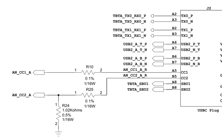

  • Hi Scott,
    Good catch.  I found a discrepancy in the docs that I have that noted an alternate configuration for CC2 when using e-Marker cables.  This alternate config wants a Pd on CC2 as seen here.
    If I remove the 0-ohm at R25, the PD negotiates as it should but the loopback device still isn't identifying itself as a PCIe device.  I don't get the EnterMode message when capturing the PD trace.

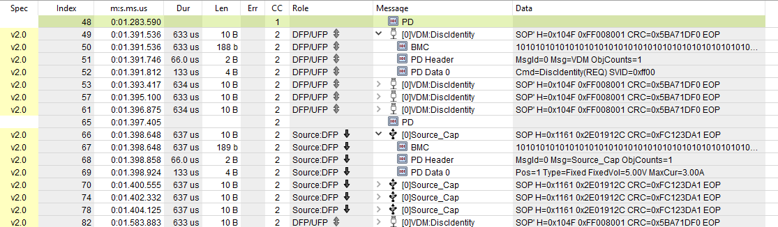

  • Hi Scott,
    I've included my current PD trace.  I don't see the the EnterMode request from the host like I do when I plug in other thunderbolt peripherals.
    I also get a Windows pop-up message stating the following: "Thunderbolt device functionality might be limited... Select message for more info."
    What I expect to happen is Windows should initialize the loop-back as a PCIe device and occupy a PCIe Root Port with an ID of 0x1577.
    Dan
  • Hi Dan,
    The trace section itself looks okay. Does the sequence stop there or go on? I expect SOP' discovery to continue to Discover SVID and Mode to determine if SOP' supports Thunderbolt mode or not. Generally there will not be an Enter Mode sequence until the PD determines if the SOP' supports TBT or not. If not, we could then see a DP Enter Mode.

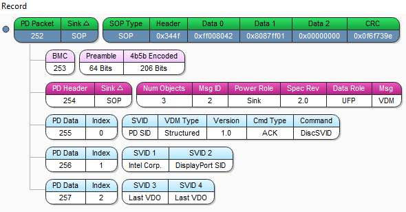

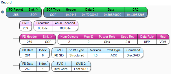

  • Hi Scott,
    The sequence continues but only includes REQs for DiscIdentity.  No other activity is observed.
    I built an image today using the Apex Creek project in the Application Customization Tool.  The Apex Creek project includes more SVIDs than the Bus-Powered Device project.  I don't get an Enter Mode REQ with that firmware either.  Iv'e included two Sink DiscSVID data structures for comparison.  The first one built using the Bus-Powered Device project showing only one SVID type and the second image built using the Apex Creek project which shows two SVID types which includes a DisplayPort SID.  Neither of these firmware traces include an Enter Mode CMD.
    Firmware based on Bus-Powered Device
    Firmware based on Apex Creek
    Dan
