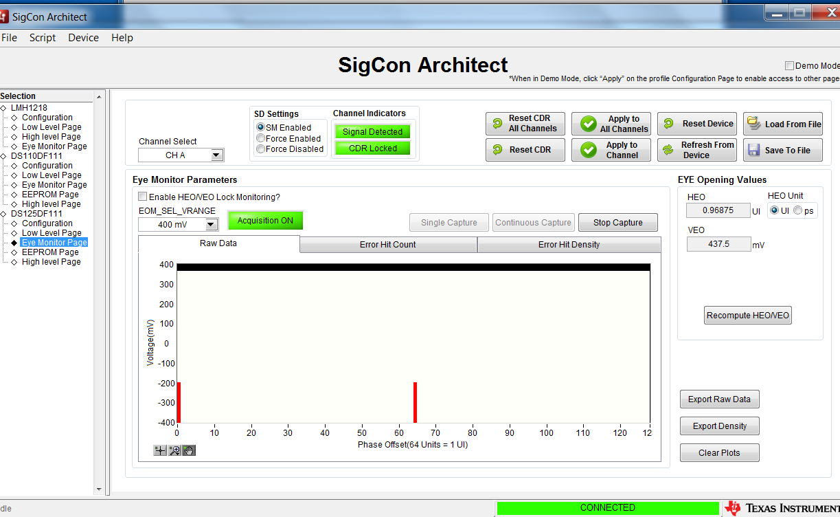

Hi
I have DS110DF111 in my board. I have made a i2c connection to this device and connected to USB2ANY adaptor. I am able to peek poke of registers from Sigcon tool.
While I was trying to check the eye using sigcon tool, the eye pattern is always blank even though the opening values is getting updated ( Example HEO – 0.78125 UI and VEO – 325mv). Is there any sequence of registers we need to write to display eye . I tried below sequence as per the datasheet, but didn’t help.
0x3E <- 00
0x2C <- 32
0x11 <- no change
0x11 <- 00

  • I am using SigCon architect V2.0.0.8. Windows version is Win7.
    My configuration is 1.25G,10.3125G mode, so default setting is good enough. On the SFI side, i am using SFP+ electrical loopback.I am able to see the link up ( LED green)
    On the EOM tab ( Eye monitor) tab, I am able to see the signal detection status and CDR status updated as locked on both the channels.
    EOM select  vrange is 200mV. Eye opening values : HEO - 0.8125UI, VEO - 337.5mV. ( does change whenever we recompute, so it seem to be working fine)
    But the eye capture is blank.  I did try single capture and continuous capture, both cases i don't see any eye. While i verify the export raw tab , all the values are zero, sometimes i see one row being updated with some
    values.
    On the CDR status both channel A and channel B 0x02 value is 0x9C.
    0x2F - 0x06 for both the channel. This confirms that rate and subrate value of 1.25Gbps and 10.3125Gbps.
    On High level page,CDR tab, mode selection is Standard. So i believe rest everything is taken care for ethernet mode with this selection.
    I feel with above settings and update seem to be correct. Not sure why aren't seeing the eye ?
    While i try in demo mode to cross verify if tool is working fine or not, was able to see the eye  and also the raw data is updating fine

    Thanks for the response. It didn't help. I tried both the options you mentioned. I am still facing the same issue.
    Below is the screen shot of eye capture. Hope this might help you to guide me further. Below is the screenshot for both continous capture and single capture.

  • Hi Krish,
    Thanks for the plots. The HEO/VEO measurements you are reading back seem very large (0.96875 UI / 412.5 mV), meaning the eye is completely open. Since this is nearly the size of the entire EOM  64x64 array, there may not be eye hits that the EOM is able to plot. I have some ideas to ensure that we eliminate this as a root cause.
    1. Can you reduce the source Tx VOD prior to the channel in which you are measuring the eye? In other words, I'd like to see how the eye looks when the VEO is closer to 200-300 mV.
    2. What test pattern are you using? A HEO/VEO measurement this large at 10.3125 Gbps seems to indicate a 1010 pattern, which I have seen issues during EOM capture because of lack of varied bit transitions. Can you try running something like a PRBS-7 or PRBS-9 pattern at 10.3125 Gbps and seeing whether this makes a difference?
    Michael

    I tried to reduce the source TX VOD < 200mV and also tried with both PRBS 7/9 pattern from source. I don't see any improvement in eye plot.
    I am attaching the snapshots for your reference. I am attaching the default setting which had >300mV VOD and reduced amplitude.
    Should we have webex session or something to work on this ? With CDR lock is happening at ethernet standard mode i believe TX is at 10.3125Gbps.
