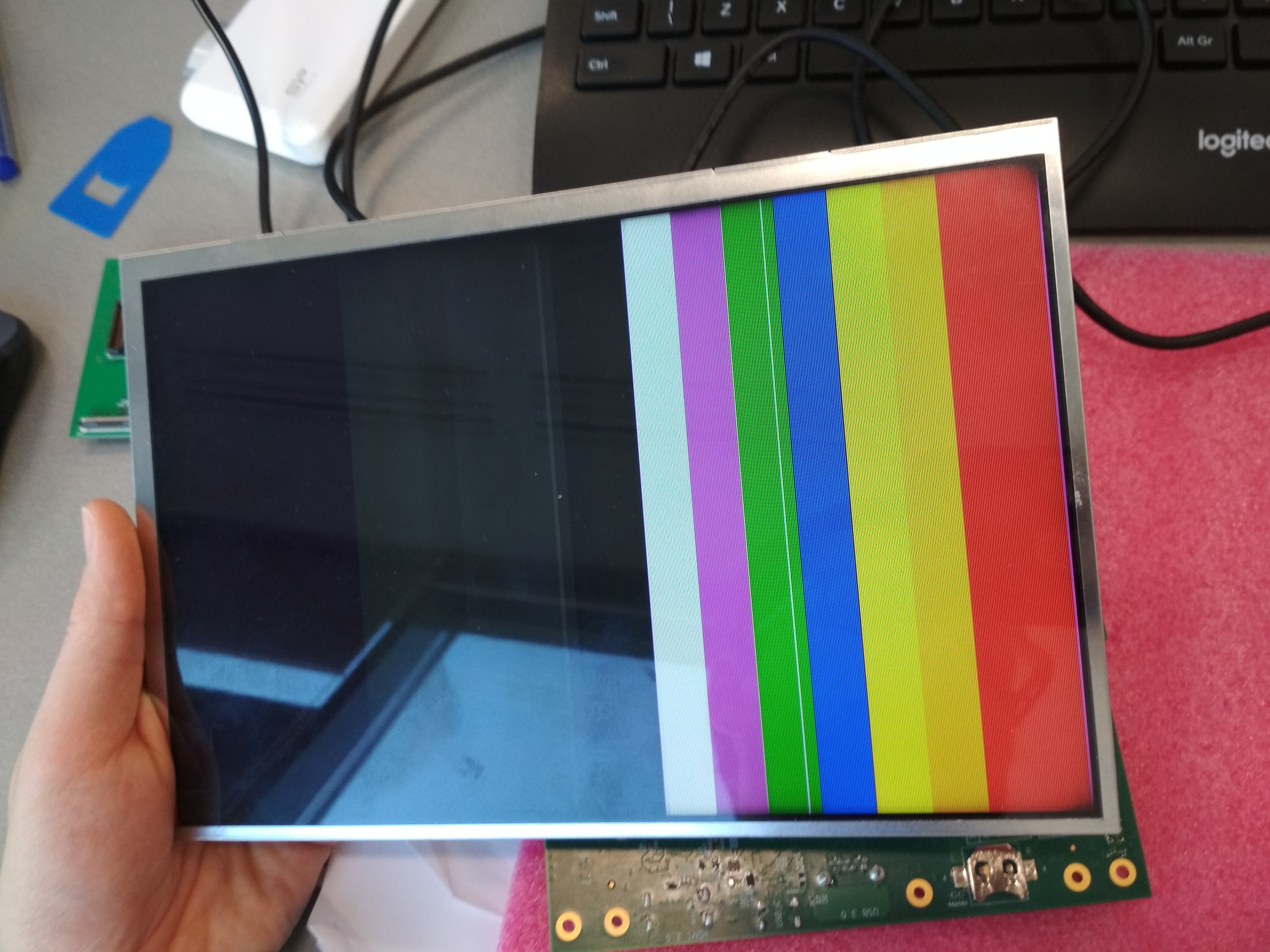

Hello

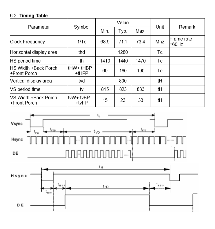

I would like run up SN65DSI83-Q1 with display, which timings is below.
PCB with bridge is our project, based on your eval board schematic and designed for 100 ohm impedance. Initialization is send via microcontroler and source DSI signal is from IMX8M.
Pattern from this IC works fine with clock LVDS from external crystal and DSI clock. When I would like convert DSI to LVDS is problem with stable screen – often screen is black and don’t refresh when source change image. Sometimes, when screen is almost as expect then I must wait for it about 5 secound and it is refresh from one edge. Next, when i change source image, display don't change image, so image is still the same. Other problem is with image in corners - is cut off (this problem don't occurs in pattern):
Can you check my initialization code ? Do you have any idea what I do wrong ?
Mateusz
