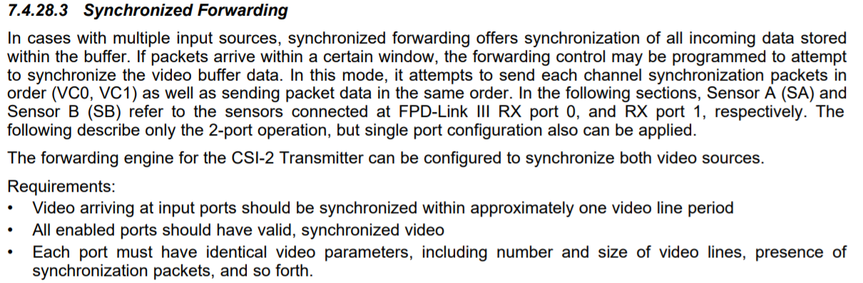

Hi team,
Could you help to check, when ub936 configured as sync forwarding, is that possible for dual input with different resolution/frame rate?
Thanks.
