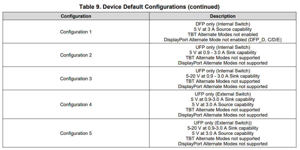

TPS65988: Does TPS65988DHRSHR comes with firmware already burnt or the designer needs to program it after board bringup completes.
Part Number: TPS65988
I am designgin a power bank and i m using this IC, I will be ordering from digikey and then board will be manufactured from PCB factory. When board will reach to me do i need to burn the firmware or TI has already installed the firmare in the chip (TPS65988DHRSHR) ?
