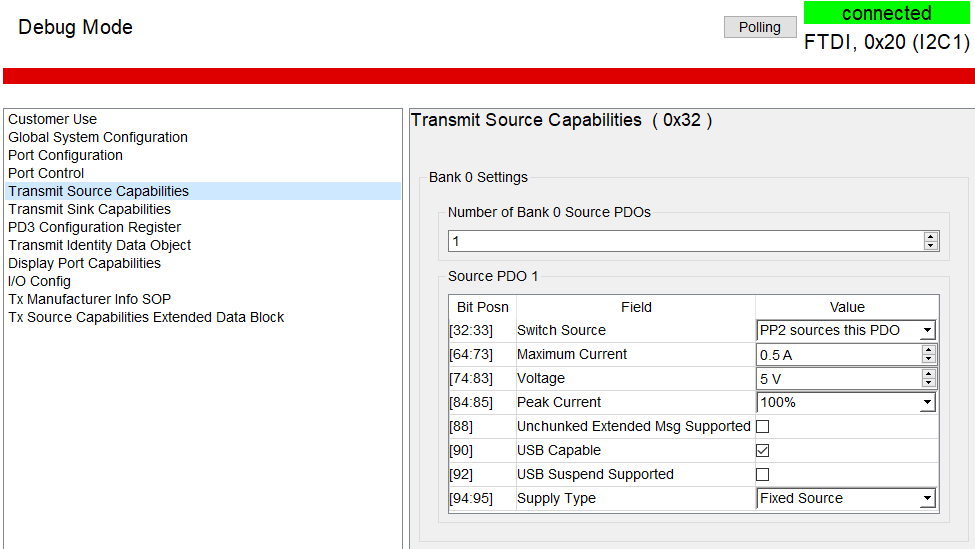

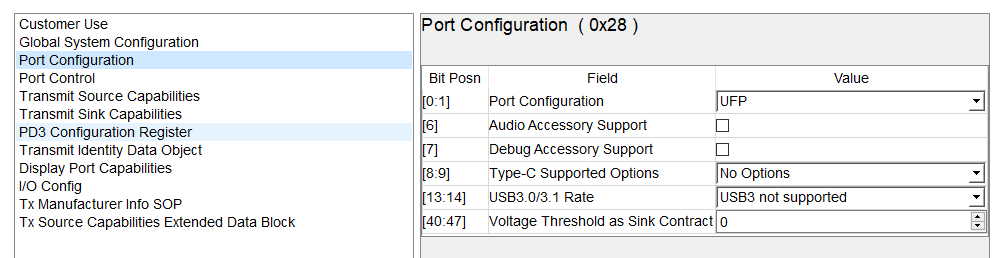

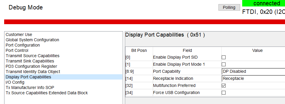

  • I was able to get this to work with the TPS65987EVM.   I attached the microcontroller D+/D-/Gnd and the 5V from controller to VA R_DCDC.   I had to use the Application customization tool to make it work.
    See my settings below.  My current questions are what is the bare minimum circuit to make it work? (I can probably figure that out)
    And, are any of these settings incorrect for my use?
    and can I compile this to a BIN file that is loaded at our factory, or do I need to send I2C commands each time I initialize?
    >>> I could test this requirement successfully with a TPS65987EVM, Expansion board and mouse, using default template.
    >>> Please share why it did not work for you. It would be useful for other members.
    >>> Power MCU from the system supply and connect DP/DM of the controller to Type C receptacle/Plug.
    >>> Configuration looks good to me. I hope this is a source only device.
    >>> There are two options;
    1. Compile this configuration and store it in external SPI flash. PD controller will load it during boot process.
    2. External Embedded controller (I2C Master) can load this configuration to PD controller during boot.
