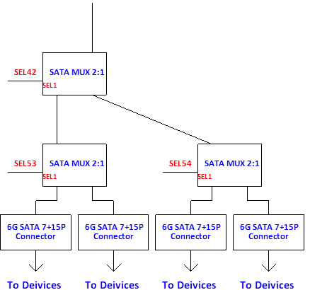

Customer would like to use two mux series, do you have any concern on this application as below?

Hi Mark,
Yes, having two active muxes in the path is likely to distort the OOB signaling. In some cases this is enough to cause system configuration difficulty on power-up.
You could substitute the SEL53 and SEL54 muxes with passive switches instead for better performance.

Hello Lee,
What the muxes with passive switches do you suggest? It will be better if it can pin to pin compatible with DS64MB201?

thanks Lee,
Do you have recommend solution of passive switch for customer?
Mark
Hi Mark,
Sorry for the delay. Here is a link to our passive switch offerings for PCIe SAS and SATA3.
