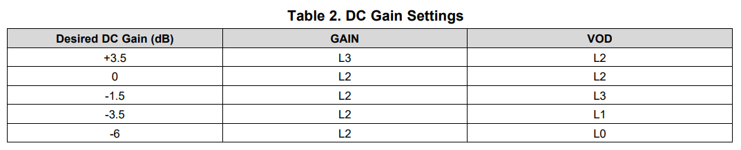

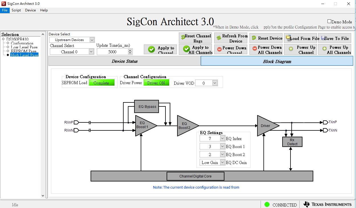

I have a question from the spec and GUI,
From the spec, it shows the DC gain has 5 levels to select, based on Gain and VOD pin.
But from the GUI, EQ DC Gain has high and low gain to select and EQ boost 1 & 2 options.
How am I going to combine the spec and the GUI to find out the relation between? Or from the spec is showing under pin strap mode with limited tuning ability, and in GUI has more flexibility for tuning ?
