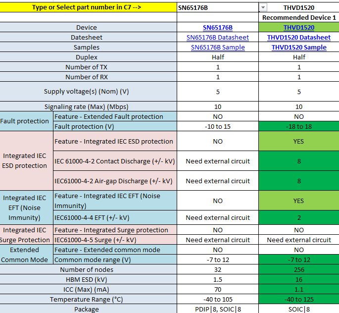

Another point is that SN65176B is a device released a while ago. You may want to check out a newer device from TI. Here is the information.
For example, you can use the spreadsheet to compare the devices.
Please let me know if you have more questions.
