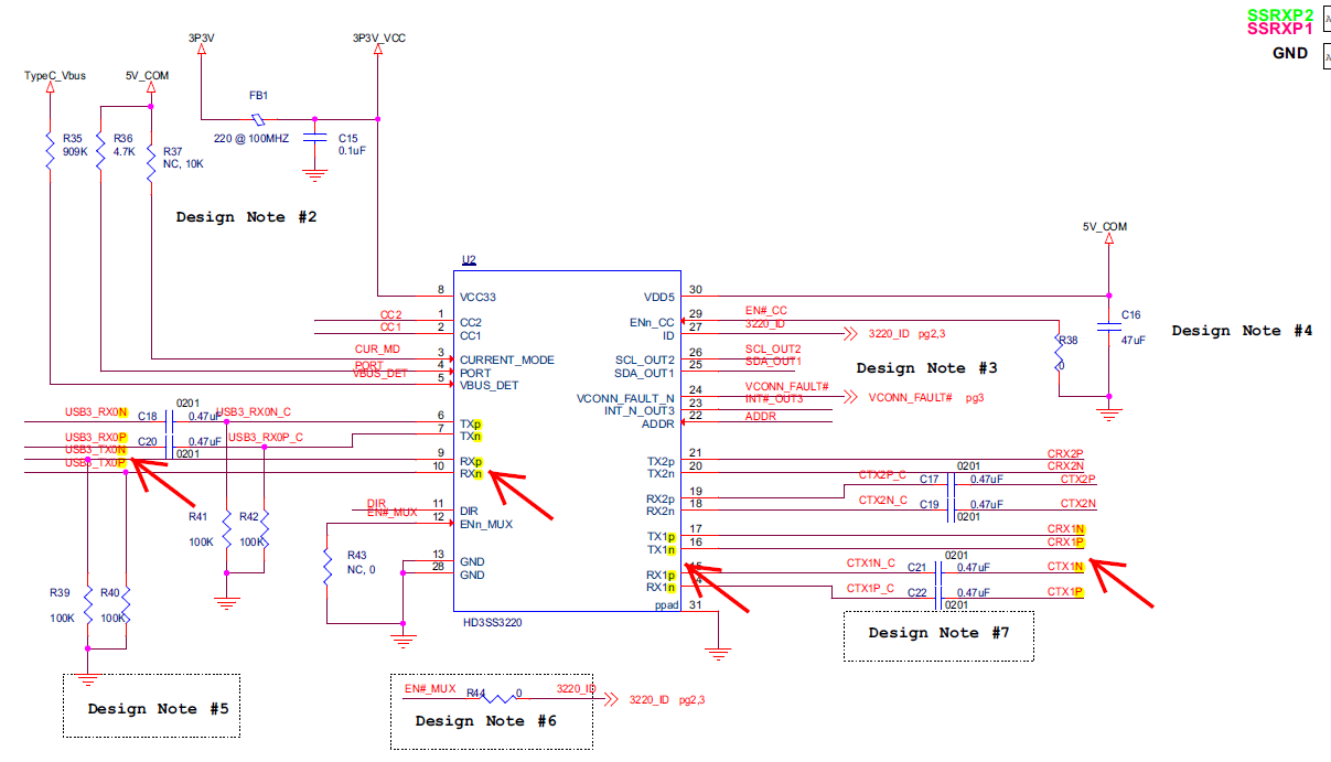

May I know the reason why HD3SS3220 DFP Dongle EVM schematic TX negative connect to the positive side?

USB supports lane polarity inversion as covered in section 6.4.2 of the USB 3.1 specification. So you can invert the lane polarity to ease the routing of the SuperSpeed signal.
