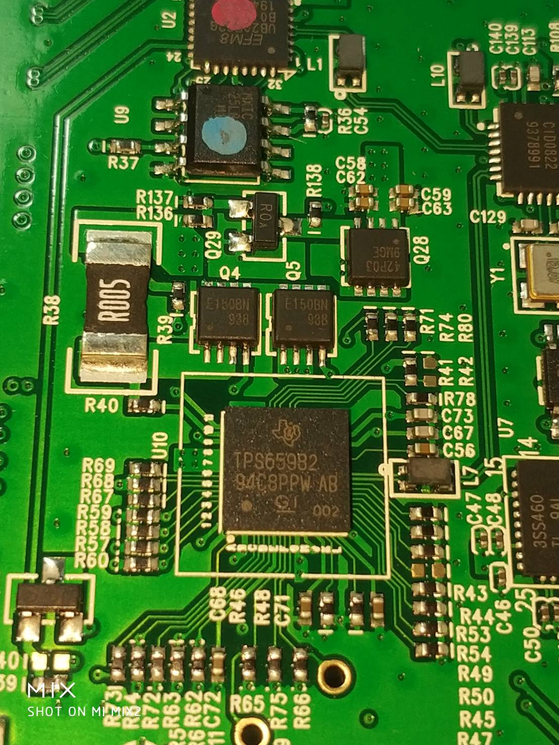

Hi :
The TI TPS65982ABZBHR is new chip

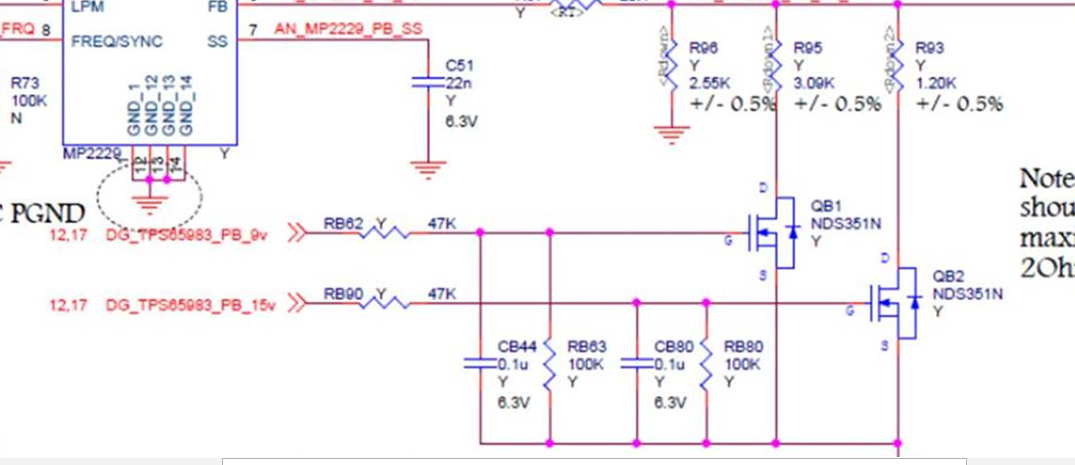

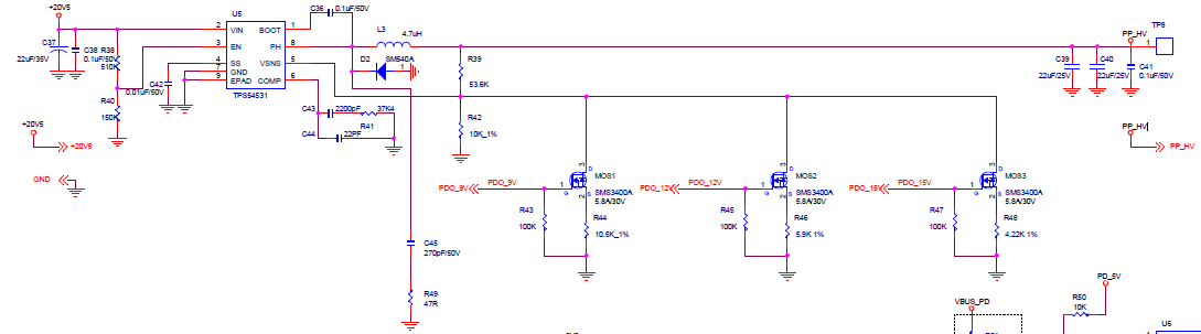

We test the PD DOCK , the dock have 5 PDO 5V/ 9V/ 12V/ 15V /20V

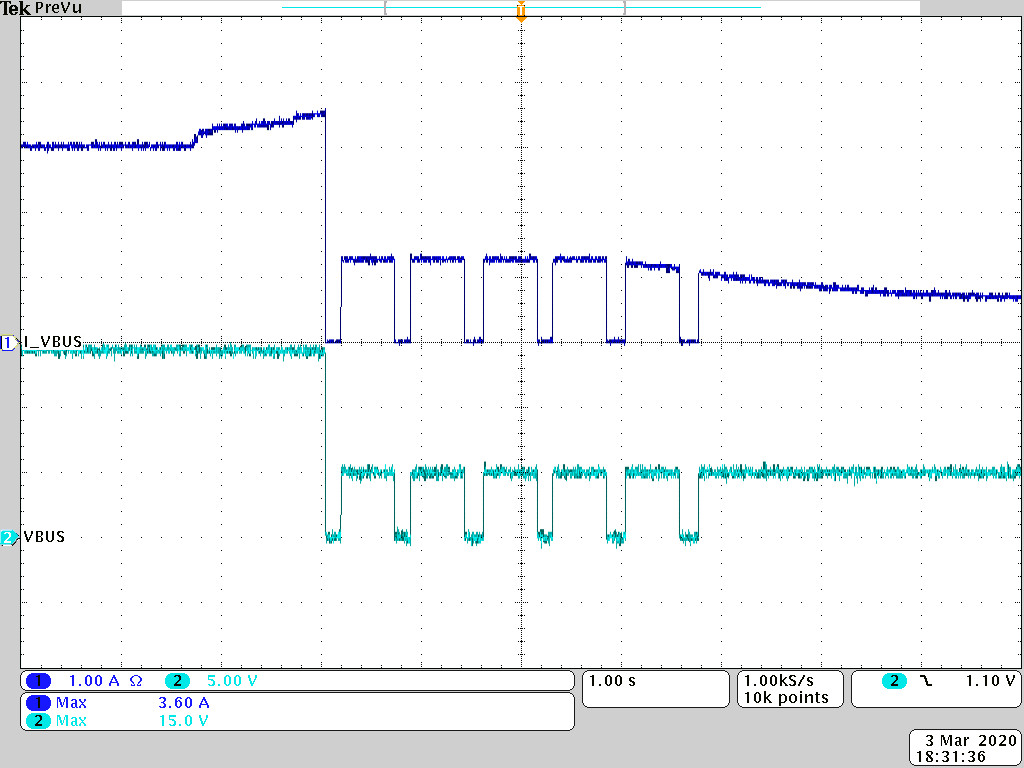

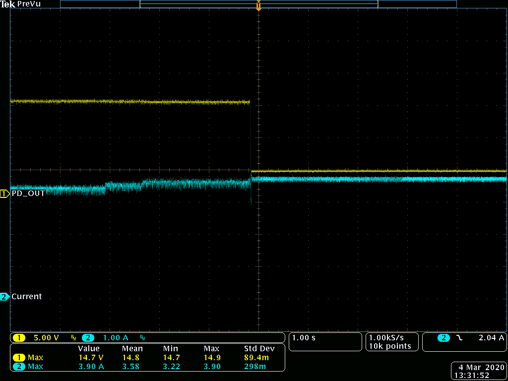

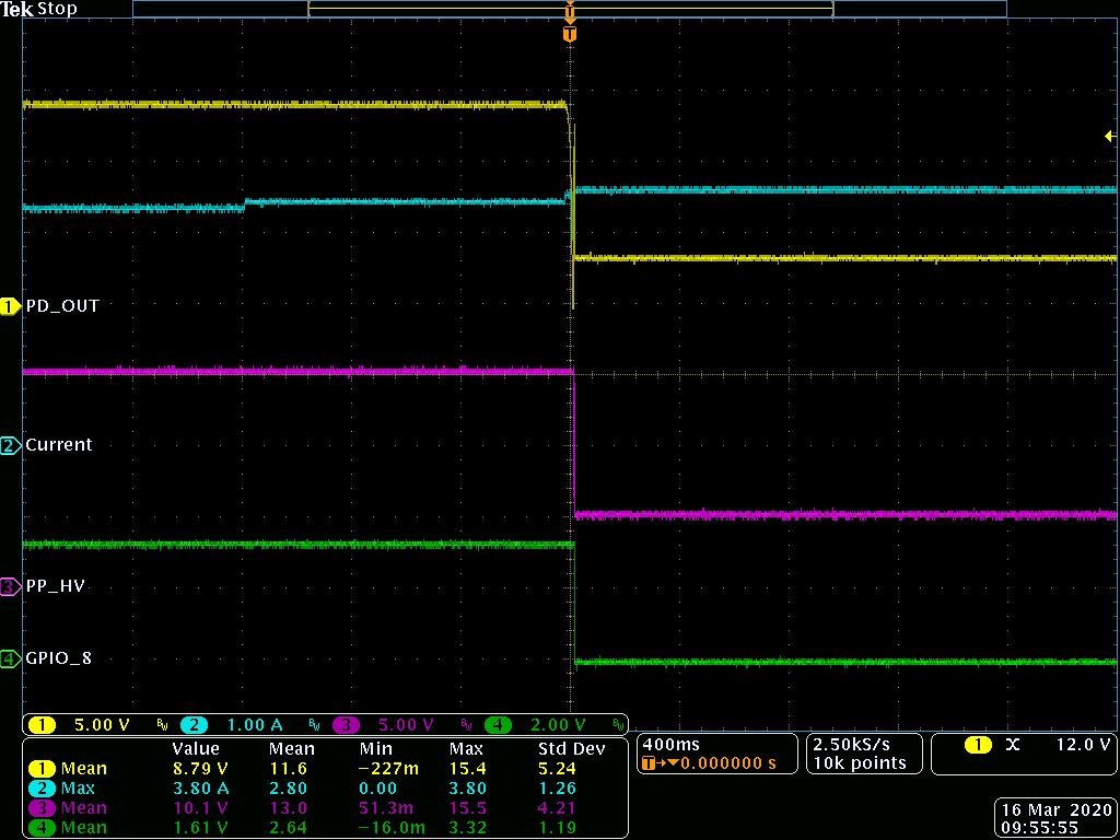

When test the over current , the PDO 15V not have over current protect , so the chip burn .
But when user the same PD Docking chip is TPS65982ABZQZR the PDO 15 have over current protect.
Note ; user the same FW version , the same DOCK only chip different .
Please help analysis the problem, Thanks!
