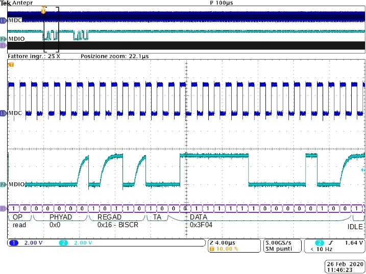

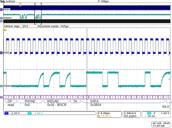

  • Hi Geet,
    I've checked my code, and all seems ok.
    I've repeated the test, and this is the result for both read operations:
    // Analog loopback test
    PHY_Write(base, phyAddr, PHY_BISCR_REG, 0x3108);
    delay_50ms();                       // wait a small time
    PHY_Read(base, phyAddr, PHY_BISCR_REG, &reg);       // return 0x3B08
    // Digital loopback test
    PHY_Write(base, phyAddr, PHY_BISCR_REG, 0x3104);
    PHY_Read(base, phyAddr, PHY_BISCR_REG, &reg);       // return 0x3F04
    PHY_Read(base, phyAddr, PHY_BISCR_REG, &reg);       // return 0x3B04
    // PCS loopback test
    PHY_Write(base, phyAddr, PHY_BISCR_REG, 0x3102);
    PHY_Read(base, phyAddr, PHY_BISCR_REG, &reg);       // return 0x3F02
    PHY_Read(base, phyAddr, PHY_BISCR_REG, &reg);       // return 0x3B02
    As you can notice, the first test (analog loopback) give correct result for both read operations, but in the second (digital) and third (PCS) tests the phy returns false result on the first read and correct result on the second read.
    It seems like some bits need to be reset by the first BISCR read operation.
    This is the MDIO line for second test (digital loopback):
    Thanks in advance,
    Marco

  • Hi Geet,
    I'm sorry but I don't have USB-MDIO tools available. I'm currently working on an embedded custom board with MCU and PHY only.
    But I've already posted, some messages above, the same oscilloscope acquisition of 2 BISCR subsequent reads, with MDIO bit stream exposed and decoded. I think it's enough to exclude driver errors.
    If you have a PHY eval board available, why don't you try to reproduce the same behavior in that?
    Marco
