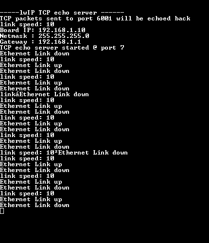

In one my custom board I am using DP83867IR to interface with Artix-7 FPGA. I am validating it with microblaze design but I am not able to see the link establishment. Always link down is showing and link is not estanblished between PC and the RJ45 port. I am struggling it from past one week. It is time critical to deliver the board. Could you please let me know the suggestions and feedback.

  • Hello Nikhil,
    1. I am able establish the link but it is taking some time to establish the link. In the RJ45 the center tapped pins connected to capacitors and the capacitors one end is connected to VCC. I removed the VCC pin in the connector then the link is established.
    2. I loaded the xilinx provided lwip application code. During it's run time link up and link down problem is coming.
    3. it's connecting to only 100Mbps and ping is working, for other speed as 10 and 1000Mbps it's not able to ping.

  • Hi nikhil,
    1. Now phy pinging is working for 10 and 100Mbps speed. we have changed small piece of code in the lwip mail, start_application for creating server. Then continuously i am able to ping for both 10/100 Mbps.
    2. Link is established for 1000 Mbps but when i load the code link is not stable. Link up and Link down is coming.
    Could you please send any one else faced the same issue.
    --Ashok

  • Hi nikhil,
    Thanks for your support. Finally the problem is solved. Teh problem is with RJ45 connector. I removed the vcc pin properly from the connector and it works fine for all modes of operatiopn.
