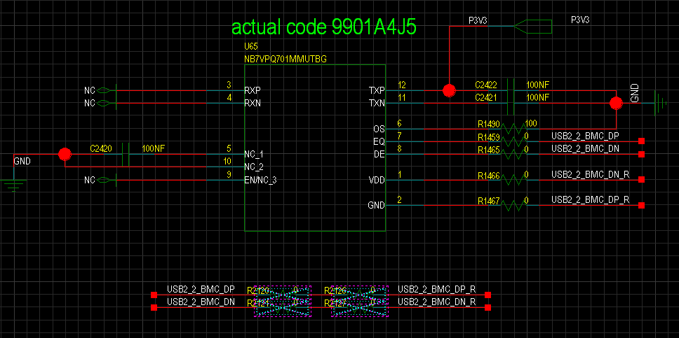

  • Hi Malik,
    We have finished the schematic below as your suggestions(please neglect the part number, the real part number is TUSB211). For the pin 9 whether we need to reserve the pull up and pull down resistor here?
  • Hi Frank,
    Notes on the schematic.
    • Pin 1 an 2 should be shorted pin 8 and pin 7 respectively.
    • There should be a 1 uF cap to ground on pin 12.
    • Pin 4 and Pin 9 should be connected to a test point.
    • Other pins look good.
