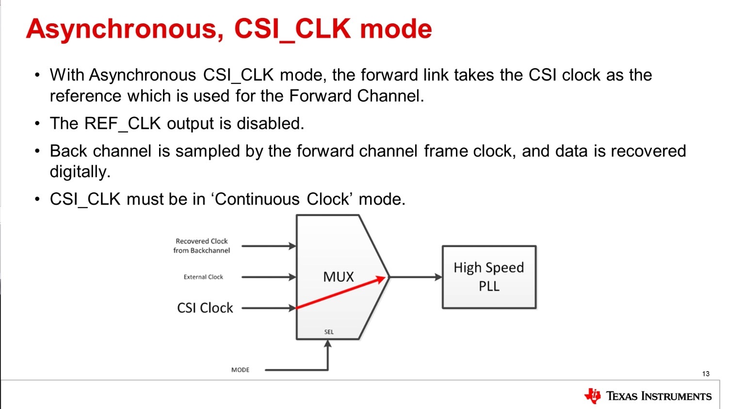

Dear team,
I just noticed that the online video https://training.ti.com/advanced-adas-serializer-clocking-mode?context=1134310-1139225-1134518 is describing the asynchronous CSI_CLK clocking mode that is not available anymore (as far as I understood), and this mode has already been reported to me twice.
Could we remove this portion of the video ?
Thanks a lot!
PA
