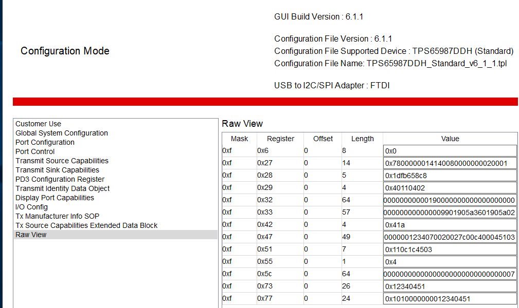

    They are programming through MCU. They have one question,
    E.g. on 0x28, GUI show 5 byte length, while application note shows 8 byte. Which is correct information? Does GUI skip "0"?

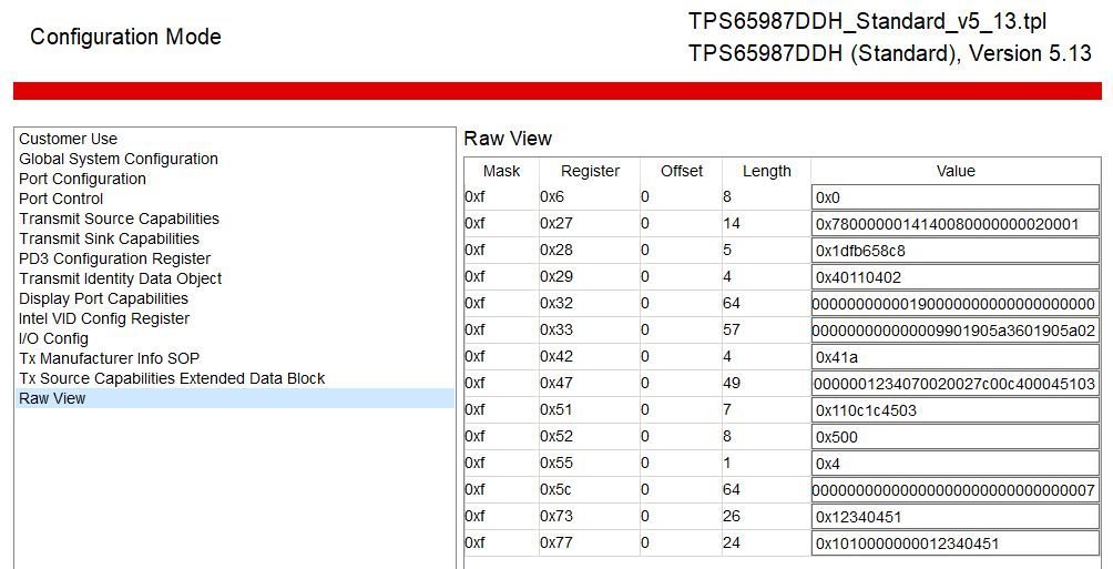

    Also, I recommend that you and your customer move to the latest configuration tool version. You are currently on v5.13 while the latest version should be v6.1.1

    Thank you for your support, however, this is not answer for their question. I confirm GUI v6.1.1, however, the word length on 0x28 shows 5, while application note show 8. Is this miss typo?
    Koji Ikeda
  • Hello Koji-san,
    Yes that is a typo within the GUI. The application note is the correct byte length and description for that register.
