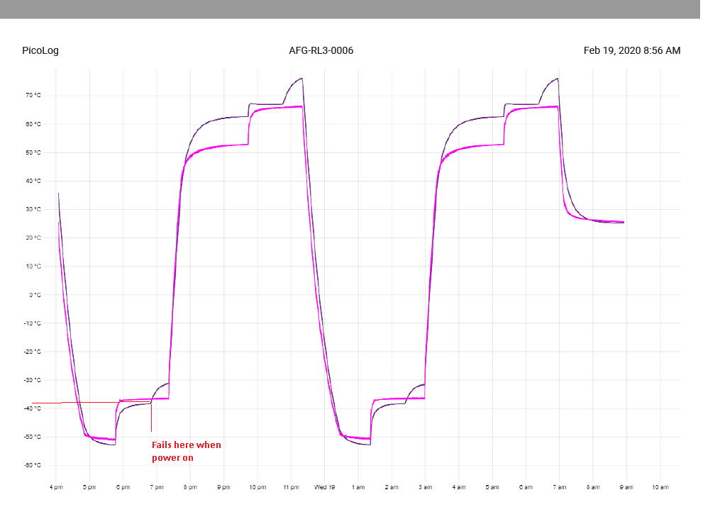

One some boards i have,
the USB 2.0 and 3.0 HUB doesn't show up in Linux only at -40deg power on.
I have not probed the signals at -40deg in the thermal chamber which i will do it.
I have few ideas or thoughts , which some body has to tell me if incorrect:
Observation:
1.The I2C works registers dumps at -40deg is yet to be taken but i2c works at -40deg
2. I cannot do a hard reset of the hub but i trued resetting the whole unit which still doesnt show the Hub @ -40deg
3.Soft reset @ -40deg over i2c doesnt work
4.The hub 0XF8 register is set to 1 to start the hub, i verified this.
5.The issue doesnt occur on all cards 1 out 5.
My suspects
1. Corrected the VBUS pin 48 release after GRST using a modification but still the issue.
2. Does the thermal pad cause issues?(the layout is done correct with vias stiched), may be not enough paste on this card?
3.Does not the crystal start oscillation?
4. The card is con formal coated so its getting difficult to figure this out
5. Am yet to probe the suspend signal(pin 45) to check if things are okay.
Any thoughts?
