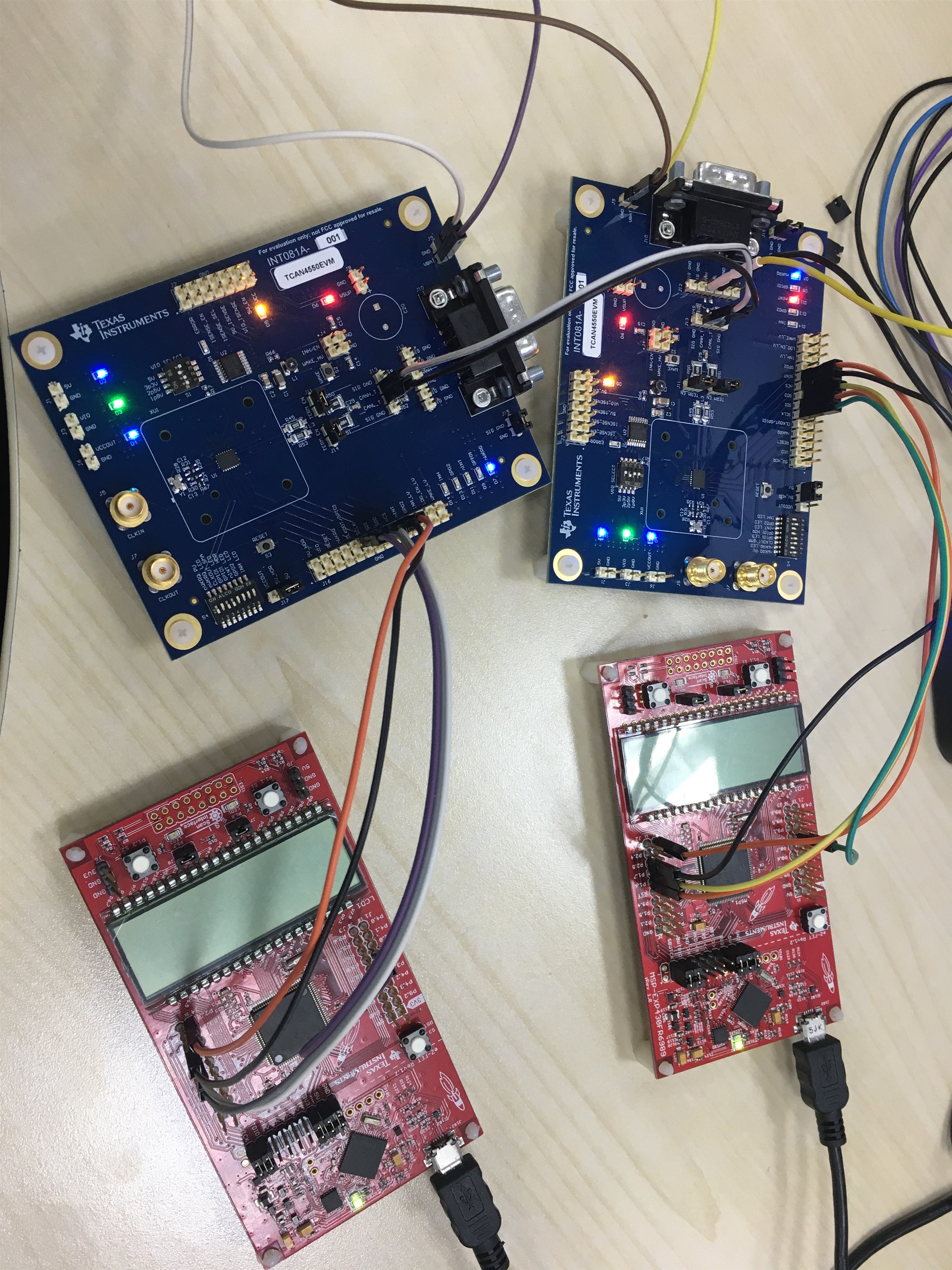

I would like test TCAN4550 CAN function, thus I would to use MSP430FR6989 to connect with it for testing.
I have 2 FR6989  + 2 TCAN4550 EVM.
The connection is shown below:
Power supply : DC - 12V
Demo: TCAN455x Driver Library Demo (Rev. A)
When pressing the S1 button (sending CAN data) at one MCU, the other MCU did not receive the corresponding interrupt, and I used a logic analyzer to monitor the CAN Bus waveform, and there was no waveform.
Where am I connected wrong on the hardware? Or do I need to make other settings?
Please help me.
Best Regards
Johnson
  • Hi Johnson,
    I don't see any ground connections between the TCAN4550 EVM's and the MSP430FR6989 LaunchPad boards.  In order for the SPI communication to be successful, you will need a good ground connection between the EVM and LauchPad.  Please connect an additional jumper wire between the EVM and the LauchPad for both sets and then try the communication again. You do not need to connect the grounds of the two TCAN4550 EVM's together, but each TCAN4550 EVM ground must be connected to the LaunchPad ground along with the SPI.
    I'm hoping the ground connections fix your problem, but if communication is still unsuccessful, then could you use your logic analyzer or scope to capture the SPI communication between the TCAN4550 and MCU's so that I can verify the SPI is functioning correctly?

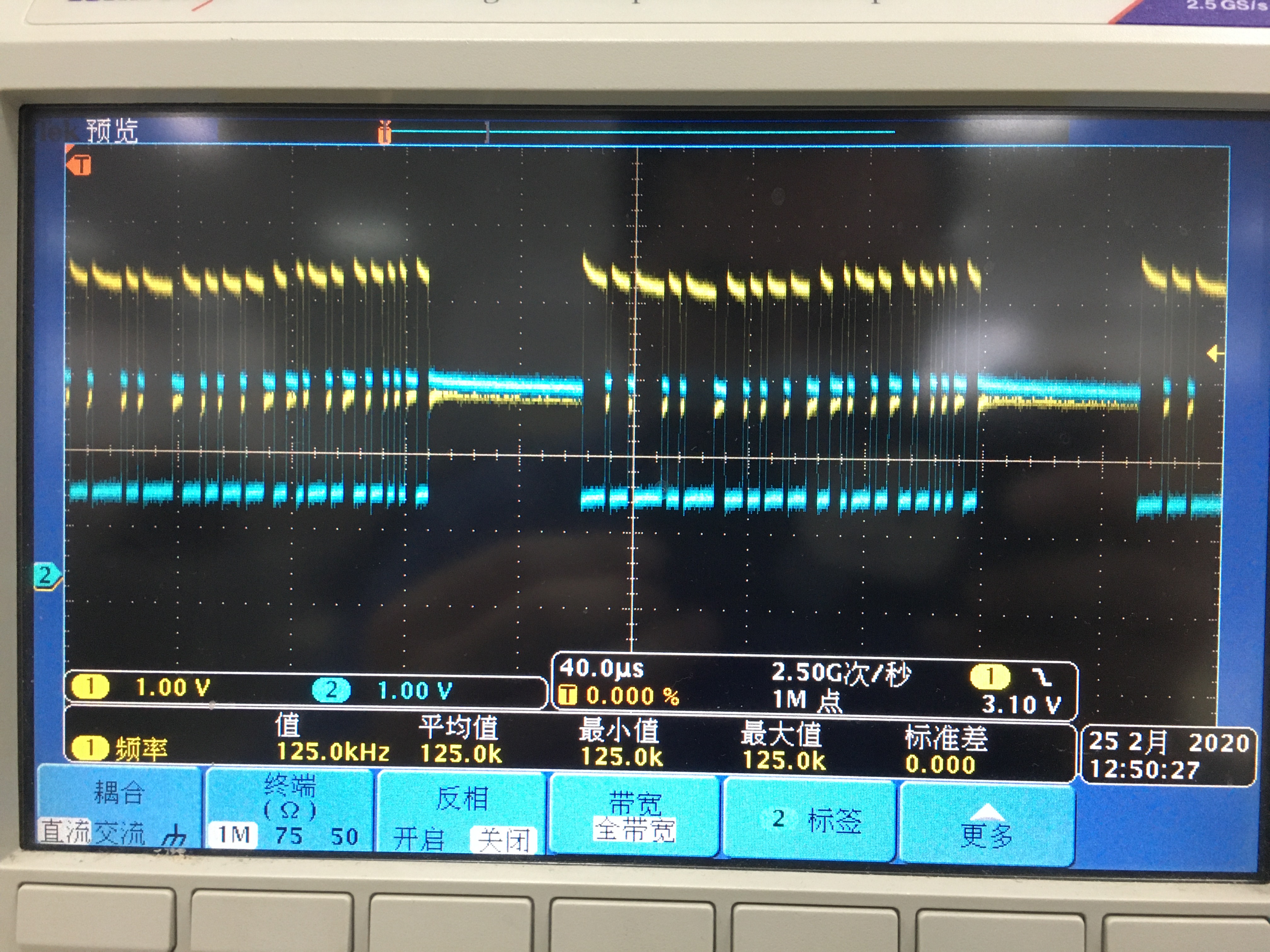

  • Hi Jonathan,
    Some update about this issue :
    I used the oscilloscope to capture the CAN bus waveform and found that:
    When Lanuchpad S1 is pressed (execute TCAN4x5x_MCAN_TransmitBufferContents (0);),
    the CAN bus has been sending data and will not stop. But the other end was not interrupted.
    Therefore, I am more confused:
    Why is there always a waveform of data transmission on the CAN bus although one transmission is finished?
    Secondly, there are waveforms on the CAN bus, but I cannot receive interrupts. Is this related to the CAD ID or filter?

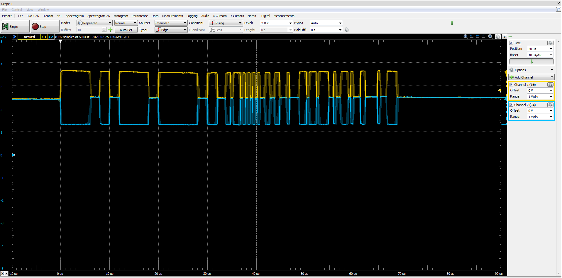

  • Hi Jonson,
    First I'll explain the repeated transmission of the message you observing.  When the controller sends a message on the CAN bus, it expects to receive an acknowledge (ACK) from another node on the bus.  If it does not receive an ACK, it will determine the message transmission was unsuccessful and it will try to send the message again until it receives an ACK.  If one of your nodes has a problem receiving a message, it will not acknowledge the reception of an error free message and therefore the original node will continuously send the message until it receives an ACK.  This is what you are observing because each press of the button should only result in a single message being transmitted and acknowledged by the other node.
    Thank you for verifying the SPI communication is good.  I believe we can eliminate the EVM to MCU connection as the cause of the problem.  However I did look at your setup picture again based upon the new information and the repeated messages.  I found one additional adjustment that I recommend you make.  I see that you are using the pins labeled "CANH_T" and "CANL_T" of Header J13 for your CAN bus wires between the boards.  I recommend you use the "CANH" and "CANL" pins of Header J12 instead.  The pins you are currently using were intended as injection points for transient signals such as noise, glitches, offset voltages, etc. and have a 330 ohm resistor between the pin and the CAN bus.  Since you are are using the same header on both boards, you have added 660 ohms series resistor on each of the CANH and CANL signals between the two TCAN4550 transceivers.  The signal amplitude of your scope signals look large enough to achieve proper communication, but just to be sure, please move the wires to J12 to be sure this isn't the cause of the communication error.
    My second observation is that your CAN waveform does not look correct to me for what I expect from the demo software.  I didn't see if your message ID and data payload was the same as mine because that portion of code is below the portion of the code you shared.  The demo code sends a packet with ID 0x144 and data 0x55, 0x66, 0x77, and 0x88 when it first starts up.  Then the code changes the buffer data to an ID of 0x123 with data 0x11, 0x22, 0x33, and 0x44 to be sent when the S1 button is pressed.  Unless the code is modified, I expect you should be observing one or the other of these messages.
    This is the waveform I expect to see from the first message with ID 0x144:
    This is the waveform I expect to see from the first message with ID 0x123:
    Observations I made on your scope waveform:
    1.) The time scale appears off.  If I am reading your scope correctly, it is set for 40uS per division.  If so, your entire message appears to take about 140uS.  Using the default bit timing settings on my setup, I see the message transmitted in about 66uS.  The demo code assumes a 40Mhz clock frequency, and the EVM should have a 40Mhz crystal installed on the board by default.  The code also sets the Arbitration bit rate at 500kbps and a data rate of 2Mbps.  So either the code settings are set different, or there is a problem with the crystal oscillators making the timing settings different.  If only one board has a problem, the other board won't acknowledge the message.
    2.) The message ID does not appear to match the expected value of either of the default messages in the demo code.  There are too many bit transitions in your messages and the Arbitration phase and the Data phase of the message appear to be set at the same frequency and not the 500kbps/2Mbps default values.
    Can you please try to measure the crystal/clock frequency on both boards, and also check the message ID and data buffer values?  There should not be any filtering applied and any valid message should be acknowledged, but if you are tying to transmit the same message as I am, the waveforms clearly don't match mine.
    Can you try powering up the boards by themselves and monitor the waveforms each board is producing.  Are they the same?  Then power on the other board and see if there are any clues to which board has a problem.  This would help point to a specific board with a hardware problem, or corrupted code, etc.  If both boards appear the same, then we need to look at all of the code again.
    Can you also try to set some breakpoints in the code and monitor the TX and RX buffer contents to see if they are as expected?  The RX of one board should match the TX of the other board.
    Hopefully something in this message will fix the problem or help us figure this out.  Once you have tried these things, let me know what you found out.
    Jonathan

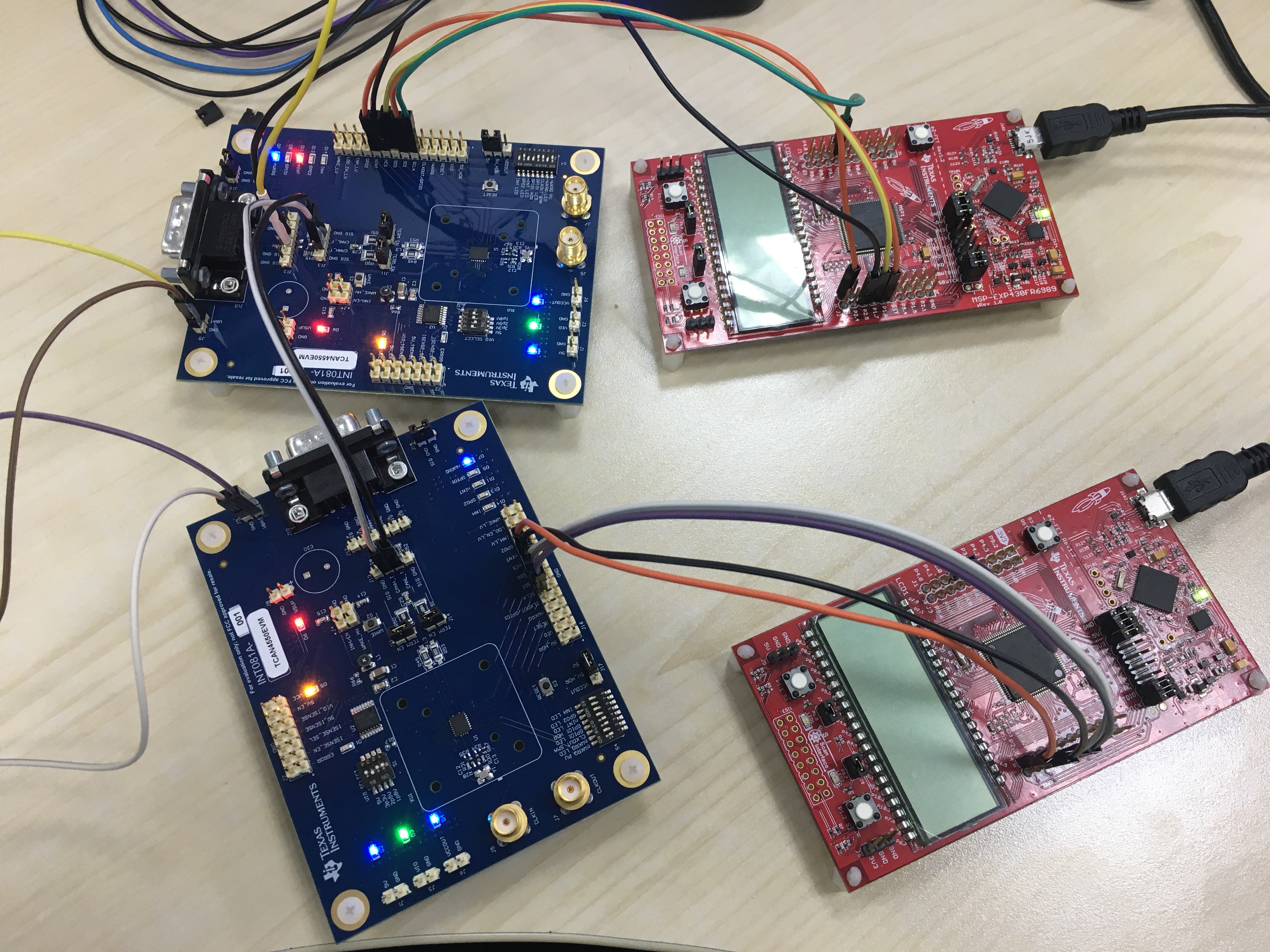

  • Hi Jonathan,
    The problem is found.
    When I use two FR6989 + TCAN4550 for CAN communication, the filter ID setting needs to correspond to the CAD ID sent by the other party.
    Now my setting as follows:
    Board1: CAN_ID : 0x123      SFID: 0x124
    Board2: CAN_ID : 0X124     SFID: 0x123
    And the test results show normal.
    thank you for your help.
