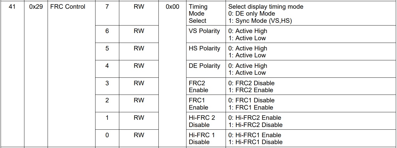

Hi all,
I have a question about DS90UB926Q-Q1.
FRC control register setting (0x29) default is 0x00, so Hi-FRC is enabled.
Is there the a need to set 0x03 for FRC control registe to disable FRC?
Ishiwata

Hi Ishiwata,
FRC is disabled by default you do not need to set 0x29 to anything for FRC to be disabled.
Michael W.

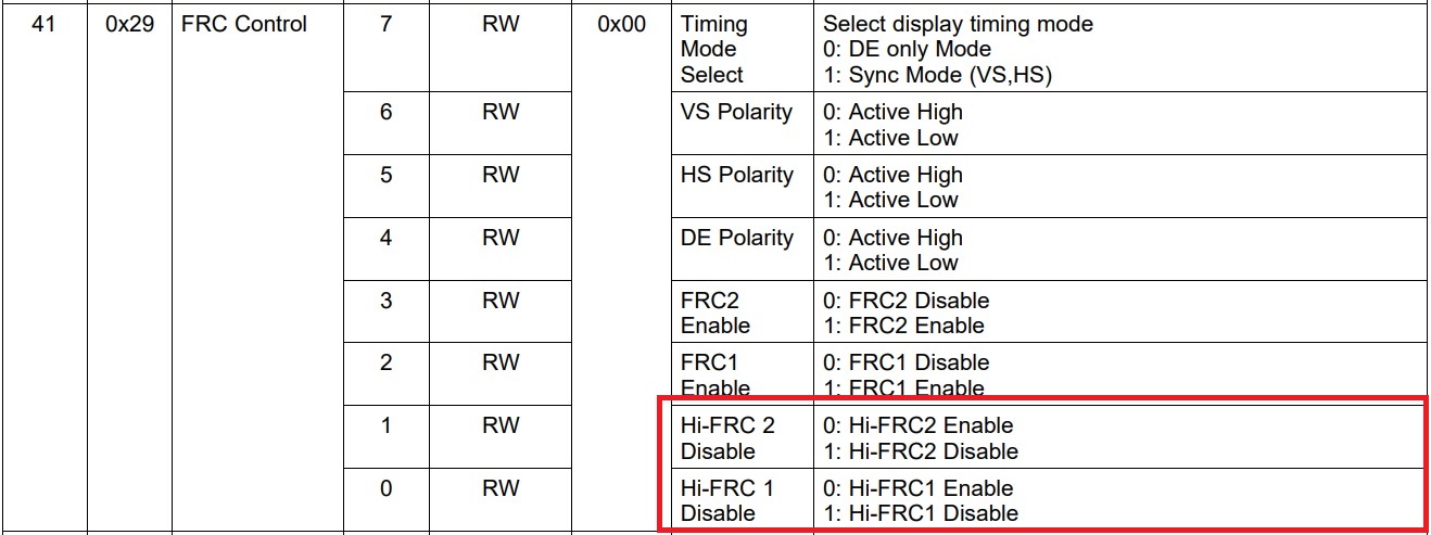

Hi Ishiwata,
Yes, it is incorrect. It should say 0: disable for both of those.
Michael W.
Hi Michael,
I hope that the datasheet is updated.
Thank you for your support.
