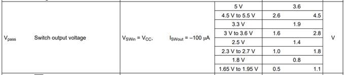

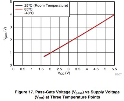

2.In their using case as above figure shown, is VCC set as 3.3V OK or not?

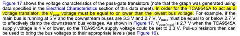

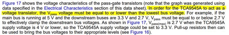

per d/s , 6.5 Electrical Characteristics & 9.2.1 Design Requirements,
Vpass needed to be equal or lower than the lowest bus voltage(1.8V in your case), so setting VCC=3.3V might not be ok, I would recommend set VCC lower(2.5V or 1.8V) to be on the safe side.

    1. Is this device support 1.8V and 3.3V for different pair output simultaneously?
    Yes, TCA9545A can translate between different downstream channel voltages as long as Vpass is set up correctly.
    The depicted configuration violates Vpass requirements. Vcc will have to be a lower value than the 3.3v in order to translate down to 1.8v. You may recommend using the 1.8v rail for TCA9545A's Vcc if it is readily available.
