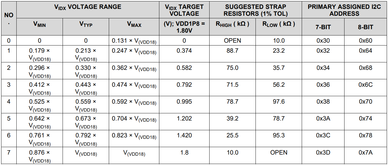

    The IDX pin can be set via the tables below for the 960, 935, and 936 respectively. However as long as the devices are aliased correctly it should work unless there will be many other devices on any of the I2C buses.

    IDX Values for 960
    IDX Values for 935
    IDX Values for 936
