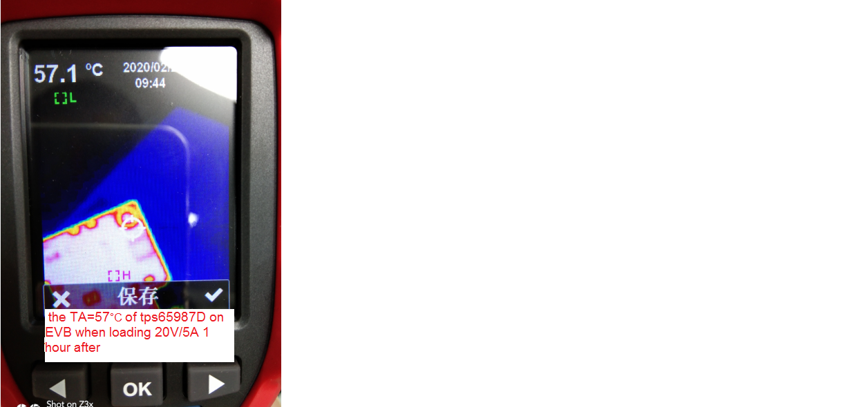

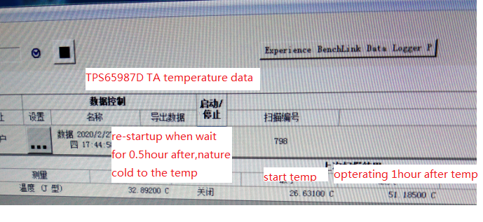

but charge 1hour after, maybe the temperature rise on the board,appoximately 40-50dgree .
then pull out the cable from the docking. next re-plug in it to the docking for re-charge.it's fail.
i am check the PPHV's Rds of tps65987D. in the datasheet show 25-33mR at Tj=25 dgree.
doesn't show the resistance of higher Tj of tps65987d.
how many is it on higher temperature?
like this, could you help to me explain the reason?(Ta=25dgree be OK, rise to 50dgree can't charge)
