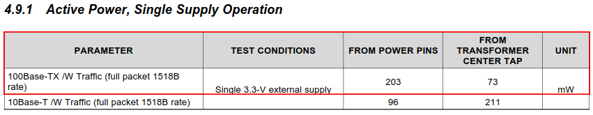

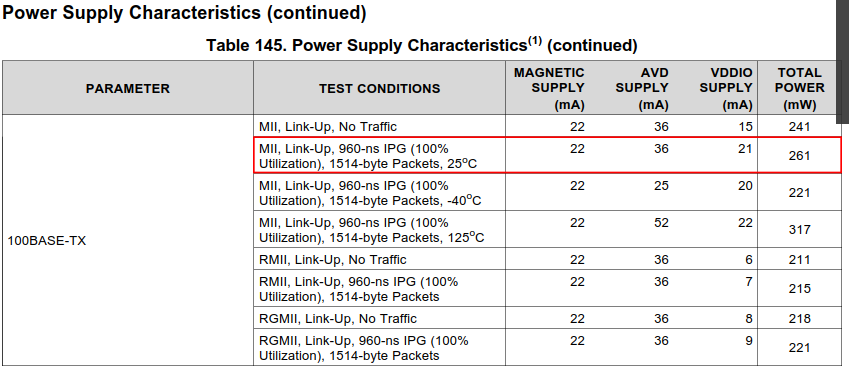

For the power consumption of TLK105 and DP83822I under the following conditions,
Let me check if it is correct in the excerpted part.
If my understanding is correct, is the total power consumption of TLK105L 276 mW?

Hi Taishi,
The highlighted portions you've selected for both devices are correct for the total power.

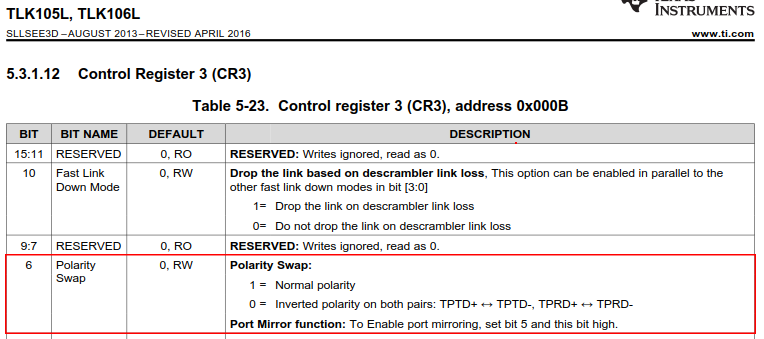

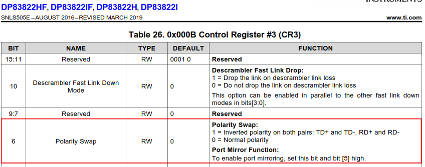

Hi Taishi,
Thank you for your patience. I have just spoke to my team about the differences. It looks to be that the TLK105 has the SAME FUNCTIONALITY and PINOUT as the compared device but is NOT an exact equivalent. I had mispoke about being software compatible and I apologize for the confusion.
As you pointed out, there are some register differences which are not clerical errors. Both the devices may have different register configurations.
Cecilia
Hi Cecilia,
Thank you for your confirmation.
I understood that it is not compatible.
However, when replacing TLK 105,
I need to know which registers are different.
If there are any other incompatible registers, please clarify the difference and let me know.
Taishi
