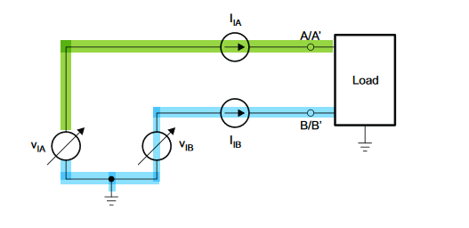

You can determine the unit-load parameter by sweeping the input voltage from -7 to +12V on one bus pin, with the other bus pin held at ground, and then measuring the input leakage current. You will measure both bus pins individually, with the transceiver both in a powered and unpowered state.
and

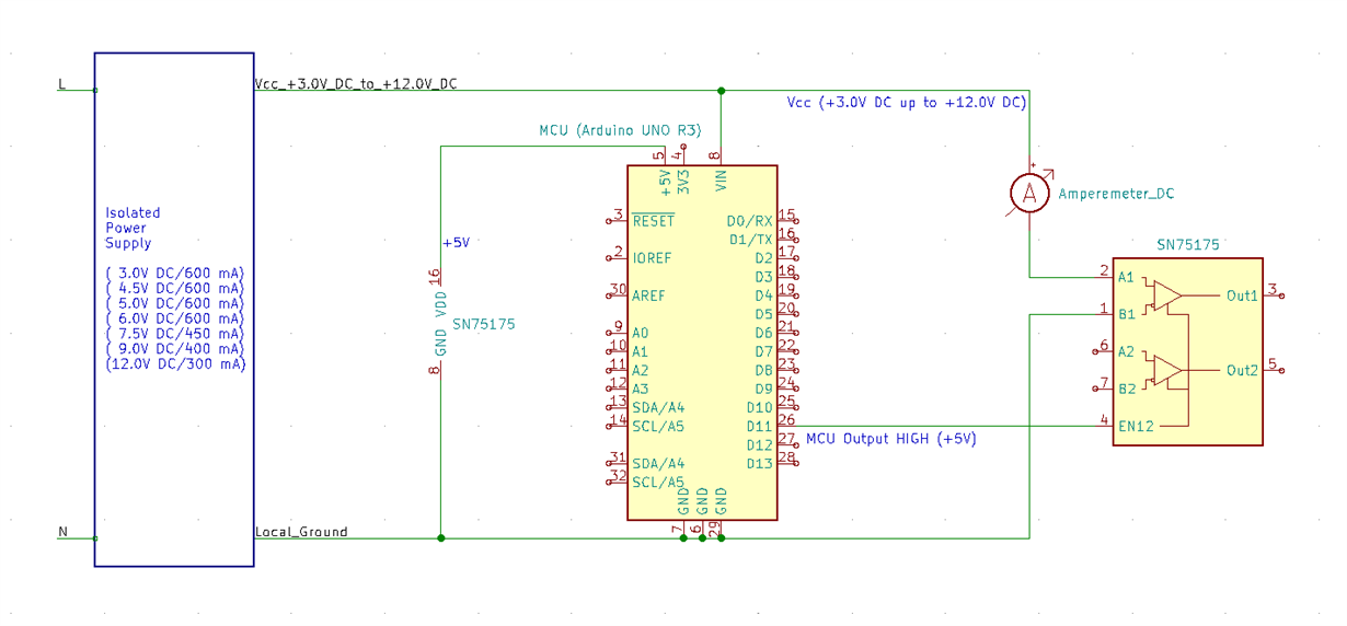

The U.L. Test Circuits I'm refering to are looking like this:

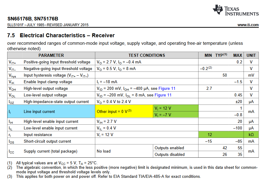

I know that I can get the Line input current / Input resistance from the according datasheet:
and

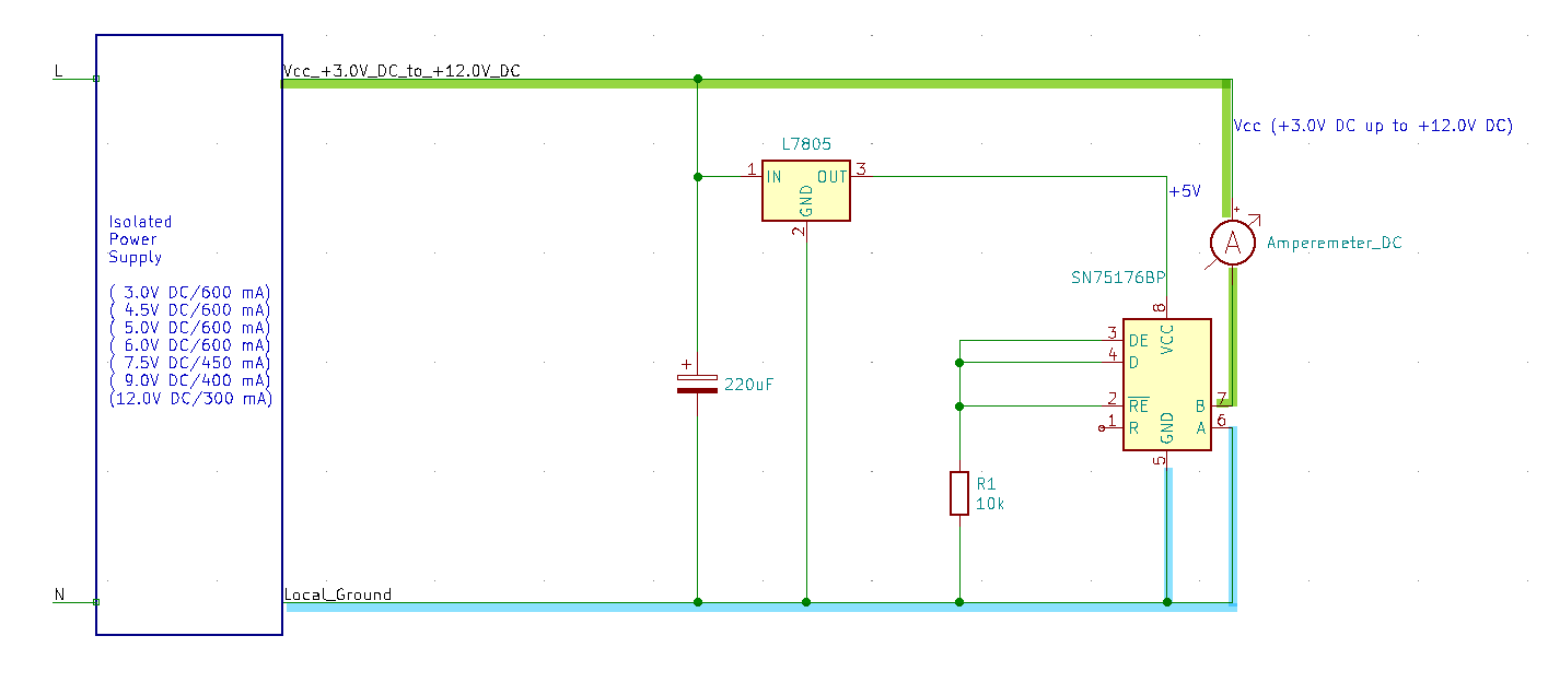

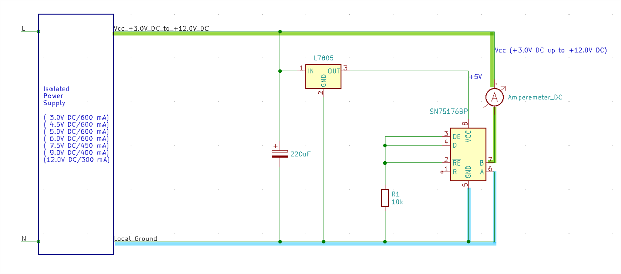

But as mentioned above I would like to measure the Line input current and calaculate the according Input resistance. For that I created the following two circuits
a) Isolated Power Supply / Arduino (Atmega 328p pu microcontroller / SN75176BP
b) Isolated Power Supply / LM7805 / SN15176BP
Vin = Vcc_PowerSupplyOut = 5V / 7V / 9V /12 V
Vcc = Vcc_SN75176BP = 0V or 5V
Driver Enable = low (0V)
Receiver Enable = low (0V)
Data Input = low (0V)
If I'm not mistaken both circuits above should reflect the test circuits mentioned in
meaning in order to measure the RECEIVERS Line input current the
  • DRIVER needs to be disabled (Driver Enable = low (0V))
  • RECEIVER needs to be enabled (Receiver Enable = low (0V))
  • Data Input doesnt matter (I put it to low (0V))

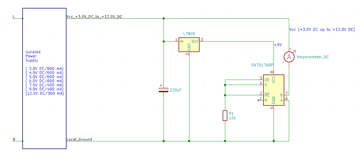

My problem is the following:
In case the SN75176BP is unpowered (Vcc_SN75176BP = 0V) everything seems to look ok, I measure as an example 0,85μA having Vin = Vcc_PowerSupplyOut = 11.16 V.
As soon as the SN75176BP is powered (Vcc_SN75176BP = 5V) and applying for example Vin = Vcc_PowerSupplyOut = 9.0 V or 12.0 V the device get's
  • extremely hot within seconds
  • the Input current measured at A or B is way beyond 300 mA
  • eventually the device is damaged and is no longer working
I figured out - or at least it looks to me - that this is happening as soon as I conect either
  • Terminal A or B to Ground
  • Driver/Enable Inputs to Ground
I'm pretty sure I'm doing something wrong here/the way I think how U.L. test circuits should work but I dont know what. Any help/explanation would be highly appreciated.
Thanks a lot in advance!
    I'd expect the input currents to be low even with the device powered as long as the driver is disabled. To start, can you please verify that VCC is 5 V and DE is at 0 V? Does the issue show up when A or B is shorted to a test voltage while the other terminal remains floating?
    Max

    To answer your question I checked VCC and DE and the results are as follows when using the circuit outlined in a) Isolated Power Supply / Arduino (Atmega 328p pu microcontroller / SN75176BP:
    • VCC --> Local_Ground: 5.02 V
    • DE --> Local_Ground: 0 V
    Everything is working fine when applying Test Voltages ranging from 3.0 V up to 7.0 V while having one of the terminals shorted to GND. As soon as I apply Test Voltages 9.0 V and 12.0 V the "issue" starts (Device get's extremely hot and finally get's damaged).
    As well no issue observed when applying Test Voltages 9.0 V and 12.0 V to either A or B terminal while keeping the other terminal floating (so no connection to GND).

    I think my problem is (partially) solved. Using quadruple differential line receiver SN75175 and following circuit
    c) Isolated Power Supply / SN75175
    Vin = Vcc_PowerSupplyOut = 5V / 7V / 9V /12V
    Vcc = Vcc_SN75175 = 0V or 5V
    Receiver Enable = high (5V)
    everything is working as expected. The device is
    • not getting hot
    • line input current is in the range of μA
    when applying for example Vin = Vcc_PowerSupplyOut = 9V or 12V to either terminal A or B while the other terminal is held at 0V (GND).

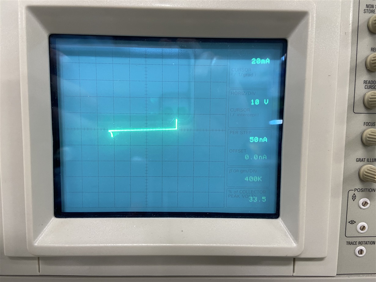

    just for the sake of completeness I replaced TI SN75176B with Linear Technology RS485-Transceiver LTC485CN8 and measured the Receiver Line input current using the circuits outlined in
    • a) Isolated Power Supply / Arduino (Atmega 328p pu microcontroller / SN75176BP
    • b) Isolated Power Supply / LM7805 / SN75176BP
    above.
    And guess what? Everything is working like a charm. The device is
    • not getting hot at all
    • line input current is in the range of μA (< 1 mA) as specified in the according datasheet

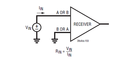

    one can determine the unit-load parameter as described here for example:
    • RS-485 basics: how to calculate unit loads and the maximum number of nodes on your network
    Peter

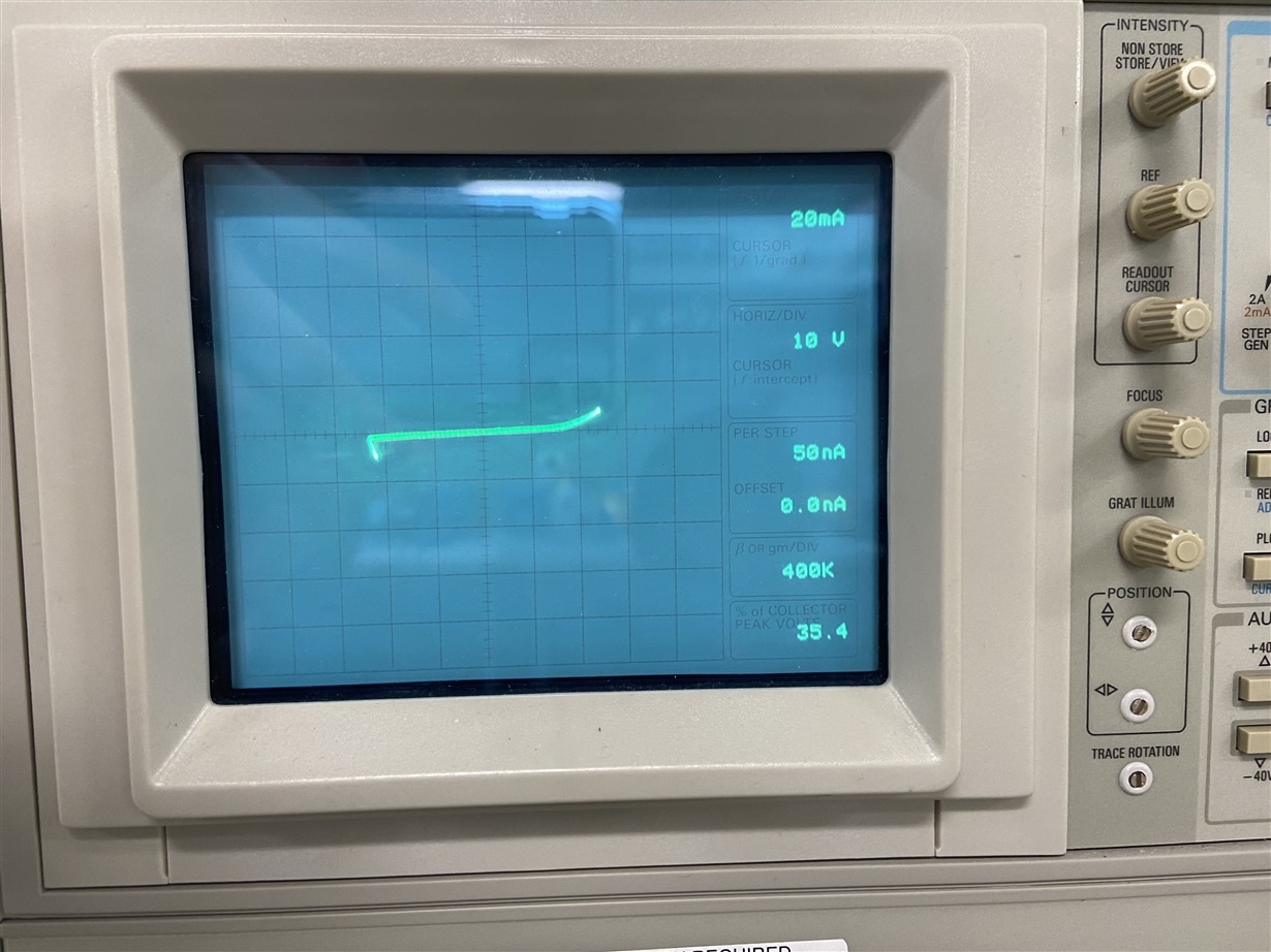

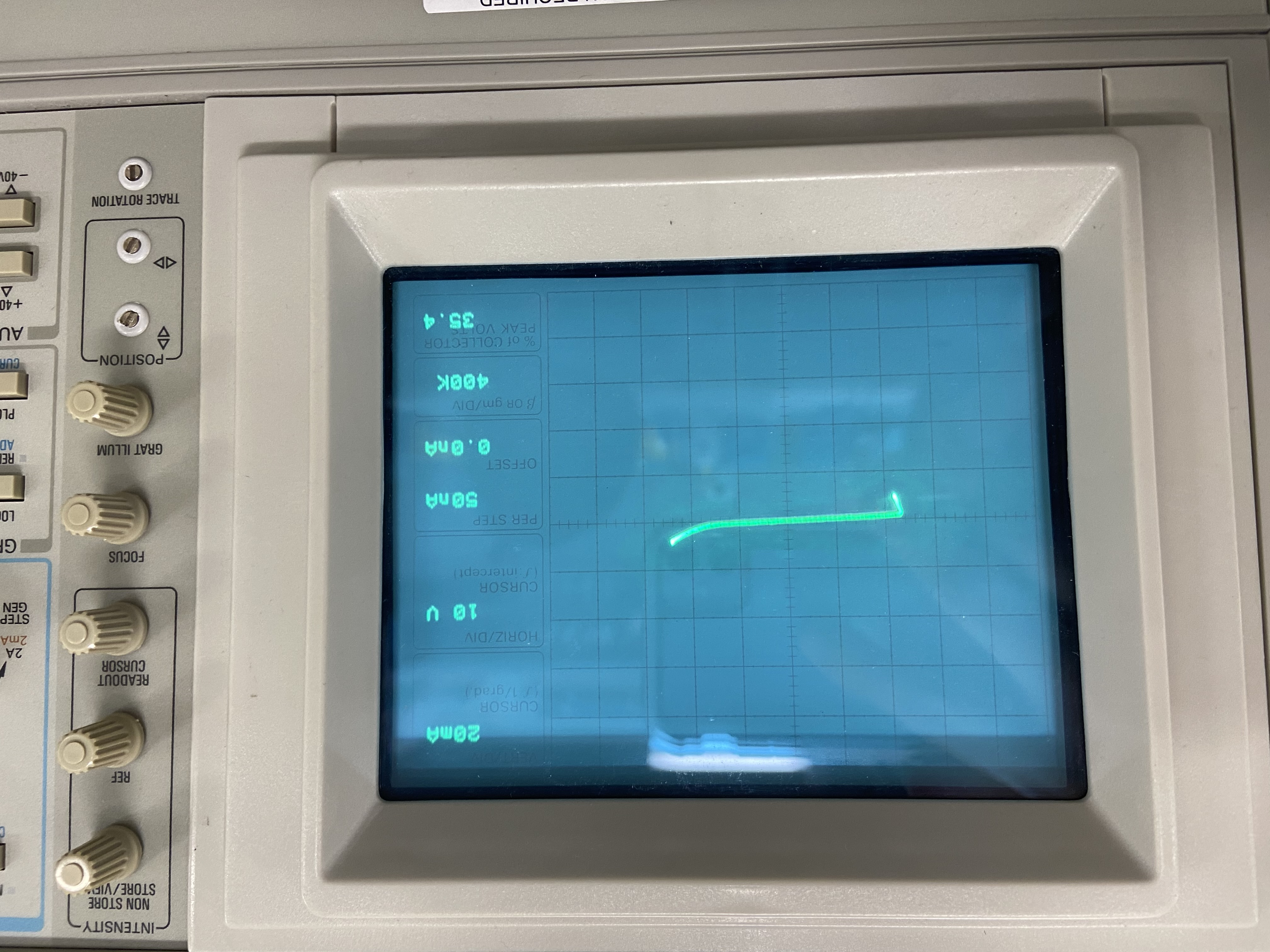

  • Peter,
    Thanks so much for your patience. I tested a few devices with high common mode voltage, but didn't see any issues. Here are the curve trace results for your reference. The curve trace machine feeds the voltage on the pin and records the current as the voltage varies.
    In this test, the device is powered off. You can see the leakage current is low until the voltage reaches +/- 20V.
    Similarly in this test, the device is powered on but in receiver only mode. The results are similar.
    Please let me know if you have further questions about the device. If you want us to test the parts you see abnormal, you can consider the return process through the vendor.
    Hao

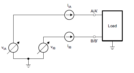

  • Peter,
    You can refer to this app note (page 6-7) about the UL measurement setup.
    www.ti.com/.../slla036d.pdf
    You can put the multimeter in serial with a voltage source for the measurement.
    I found a diagram online and hopefully it's helpful to you.
