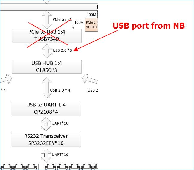

Branched serial port from TUSB7340 -> GL850 -> CP2108 failed set request when turn on & off sequentially.
Below is is the log, could you help to check why request fail?

When entering 2006 (port 6), the request is fail and pop below error message:
[  177.964613] cp210x ttyUSB8: failed set request 0x12 status: -110
[  183.084606] cp210x ttyUSB8: failed set request 0x0 status: -110
[  195.884602] cp210x ttyUSB9: failed set request 0x0 status: -110
[  195.890523] cp210x ttyUSB9: cp210x_open - Unable to enable UART

    There isn't enough information from the telnet log to determine why the CP210x device is not responding to the USB commands.  Do you see the same behavior if the hub is removed from the USB path?  Does everything work on initial power up, but fail after power off / on cycles?
    JMMN
  • Hi JMMN
    ANS01: Yes, we bypassed tusb7340 and connect USB path from NB (Windows OS), then test is fine.
    ANS02: No, the error happened every time when we do the test.
    Q01: Can tusb7340 support PCIe gen1 to USB2.0 with linux OS default driver?
             If yes, have you ever tested it or is there demo board?
    Q02: Is there port number limitation when tusb7340 is  branched from one pcie gen1 to 3xUSB2.0 to 48xserial ports?
    Q03: Can you help to check if there any problem about the architecture tusb7340 --> GL850 --> CP2108?
