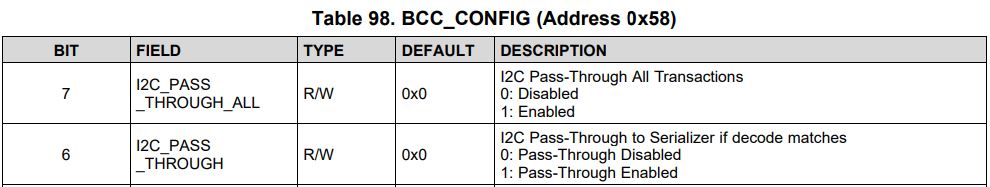

Part Number: DS90UB954-Q1
Dear team,
Could you let us know the different bit6 and bit 7 of 0x58?
thanks.
Ben
Hello Ben,
Pass Through—This I2C control enables communication with all the remote devices, whose device ID
and corresponding device Alias fields is defined into the local device (Ser or Des).
Pass Through All— This control enables all I2C transaction over the serial link that are not addressing
