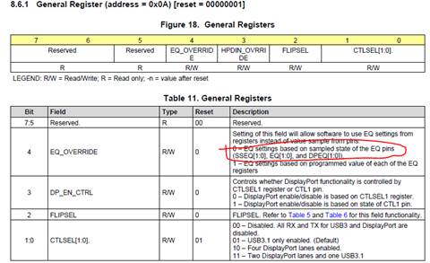

Would you help to explain the definition of parameter “ EQ_OVERRIDE ” ?
If the setting is 0, does it mean that EQ is based on GPIO, even the I2C_EN pin isn’t “0” ?
If we want to adjust EQ by register, should we set the EQ_OVERRIDE parameter to “1” ?
