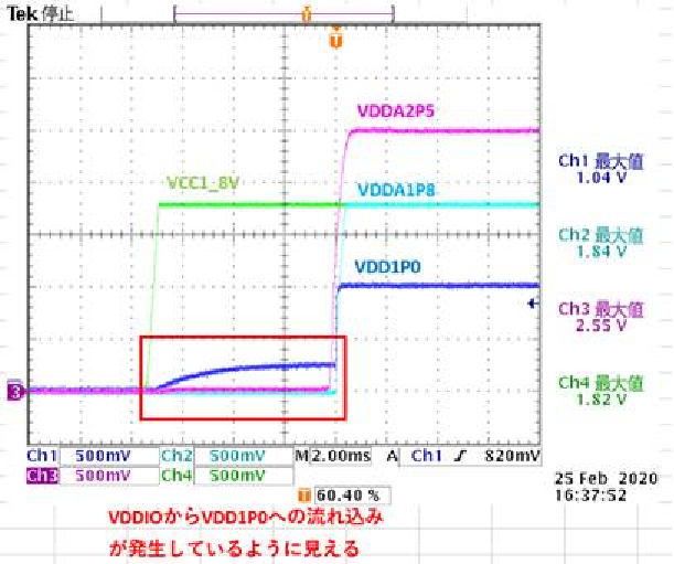

I would like to ask you check a power sequence of target board.
VDD1PD goes up around 200mV when VDDIO ramp up. There is no sequencing requirement of VDD1PD and VDDIO.
Is this problem?
It looks VDDIO supply current leaks to VDD1PD.
Could you please give your advise?
