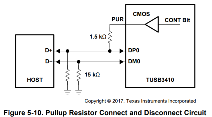

I'm trying to figure out the correct passive components on the DP/DN lines between the TUSB3410 and a type-B USB port.
Figure 5-10 shows 2x 15kOhm pull-down resistors:

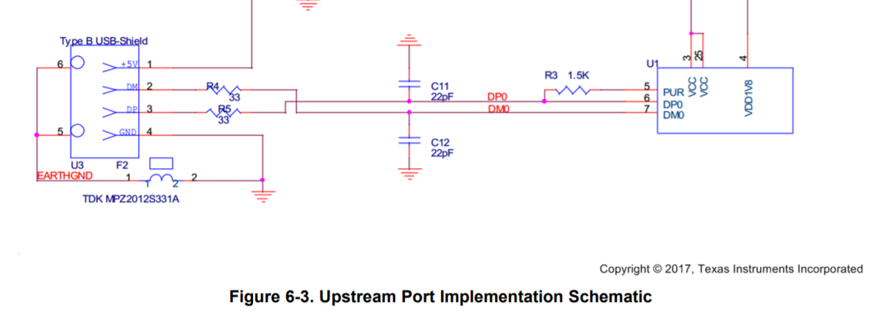

Figure 6-3 shows a series 33 Ohm resistor with a 22pF capacitor to ground.
The EVM would seem to agree with figure 6-3 as well:
Which implementation is correct?

  • Hi Donald,
    The datasheet image is showing in internal termination for TUSB3410. The passive components, series 33 Ohm resistor with a 22pF capacitor to ground, are implemented as a form of edge control to help with signal integrity issue in some applications. I recommend implementing these passive components.
