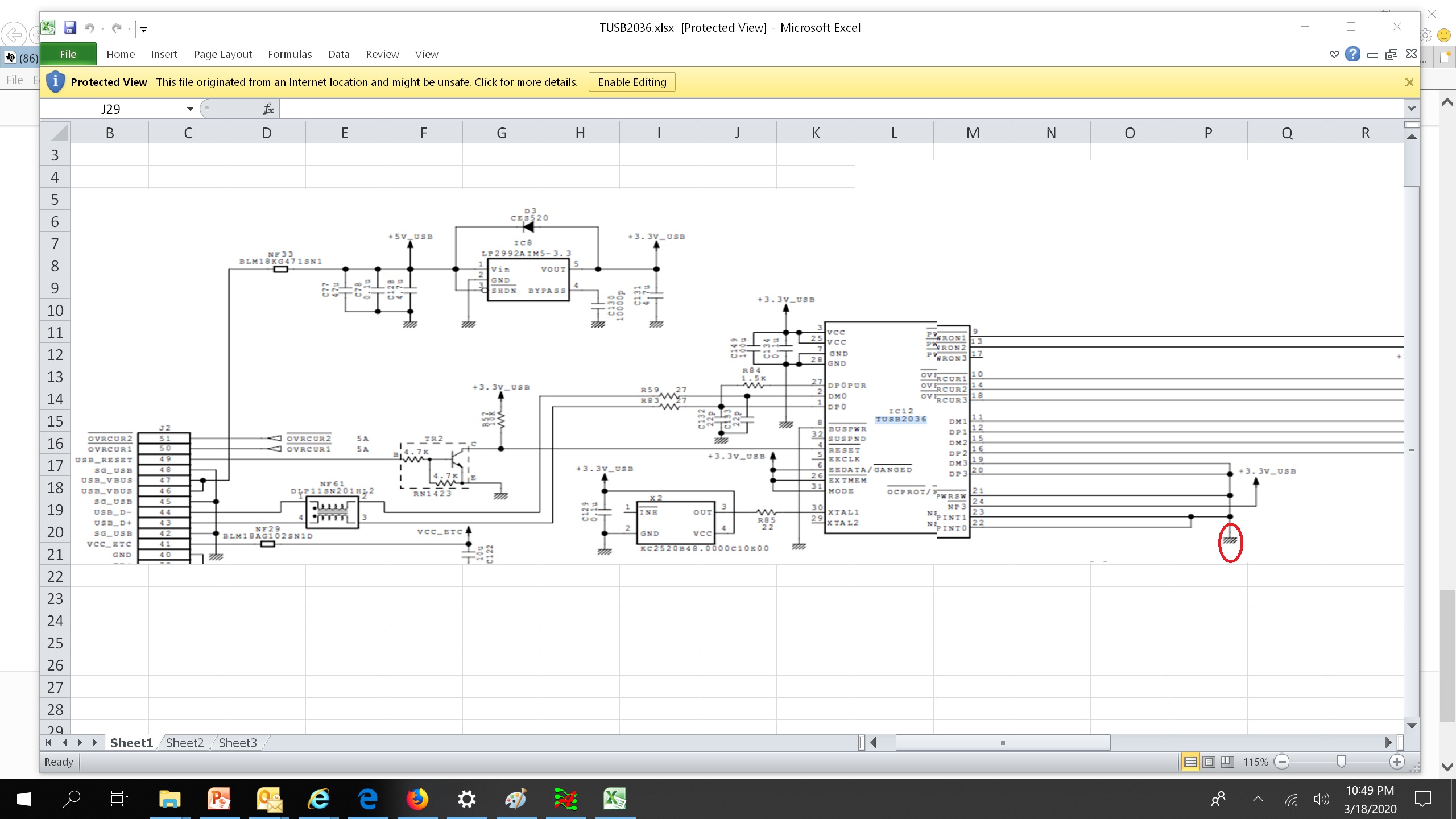

Part Number: TUSB2036
How should unused DM/DP pins be terminated?
And could you review my customer's schematic?
Kuramochi
Kuramochi
you can just leave unused DP/DM floating., sure we can help review schematic.

Brian-san,
I sent schematic on private message.
Could you check it?
Kuramochi
Kuramochi-san:
your schematic looks good. I saw DP/DM3 is pulled low.
Brian
Brian-san,
DP/DM3 is pulled-up on the schematic.
Should they be not floating but pulled-down?
Kuramochi
Brian-san,
I apologize my misunderstood.
