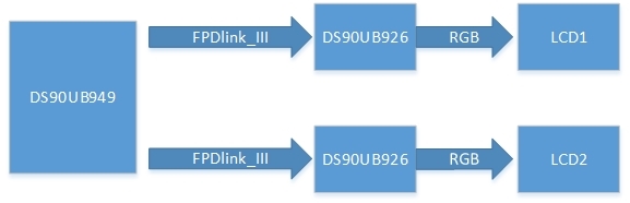

Hi Team,
May I ask whether 949 could support the following application?
- Drive different panel with different contents
I know 941 could achieve this kind of application, but what about 949?
thanks!
Part Number: DS90UB949-Q1
Hi Team,
thanks!

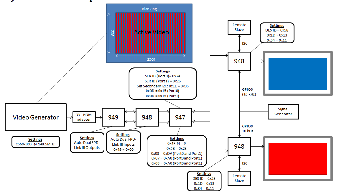

Hello Amelie,
This is possible if the two LCDs have the exact same video timings/PCLK and the HDMI source can provide the video in alternating pixel format.
Here is an example using 949 to provide alternating pixel video to 947 but the same concept can be applied in the case where the back to back 948/947 are removed:
