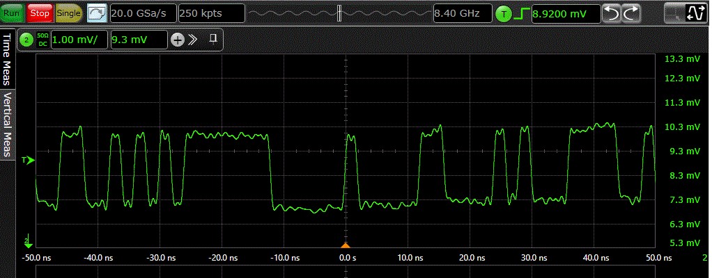

    And what I get from the optical detector is:
    So the amplitude is 3 mV and DC is 8.8 mV

    So some 18 mV DC and some 4.5 mV amplitude.
    The DC values are consistent with the laser datasheet, showing a knee at 20.2 mA and a slope of  1.84 (mV detector/ mA laser), but if the modulation current was really 10 mA the expected amplitude would be 18 mV and it's 3 mV. Same for the second experiment, 15 mA * 1.84 = 27.6 mV but it's barely 4.5 mV.

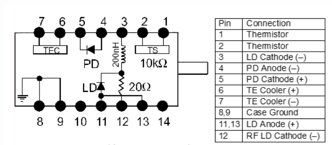

    The laser itself has this circuit:
    Where the RF LD cathode and LD anode are connected to the other SMA connector. The laser is mounted on a separate board.

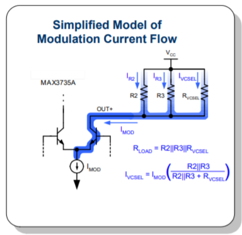

  • An application note shows how the modulation current is split across different paths so not all the current goes to the laser, unless, of course, what you call "load" includes the pull-up resistor that doesn't generate any light.
    The schematic above is DC but I think it's also valid in AC as the capacitor is a negligible impedance
