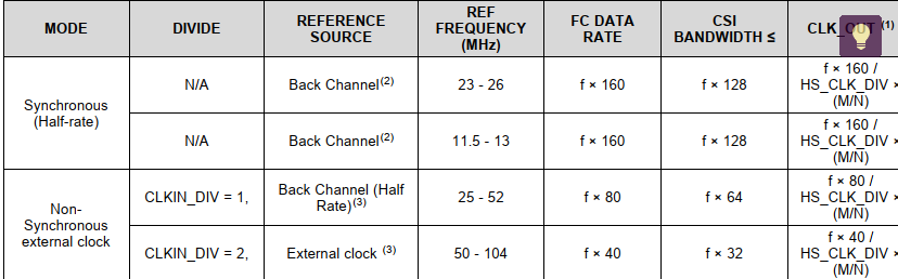

Our customer is evaluating DS90UB953-Q1 and DS90UB954-Q1, they have below questions:
1. What is the speed of FPD-LINK? Can it be set?
Is speed related to camera data or resolution? We see the data shown in Table 6.4.1
2. If you select asynchronous external clock mode, the speed of FPD-link is the last set of the screenshot, such as the speed of 50M * 40 = 2G. If this speed is fixed, it has nothing to do with the camera sensor, as long as the sensor meets less than f * 32, this is right?
3. When using STP mode transmission, whether it can realize single direction transmission and data be sent from 953 to 954 and then deserialized into MIPI signal? We want to transfer the camera image data to 954 and then deserialize, can this be achieved?
Rock Su
  • Hello Rock,
    1) The Speed of the Link is the FC Data Rate mentioned in the table above. This can be calculated as explained.
    2) Correct.
    3) There is no difference between using STP or Coax mode. This is just indicating the used cable. It has nothing to do with the datarate.

            The second question,The unit of transmission speed of FPD-link is Gbps ?and The  speed of FPD-link is  2 Gbps,and  the clock frequency of the transmission speed is 1GHz?
            As shown in the picture below ?
    1- For STP normally people are not using PoC. Nevertheless, yes, it is the same calculations.
    2) Yes, Gbps.
    3) Yes, if you are using Non-Synchronuous External Clock mode, and you set CLKIN_DIV=2, then FC 40.
