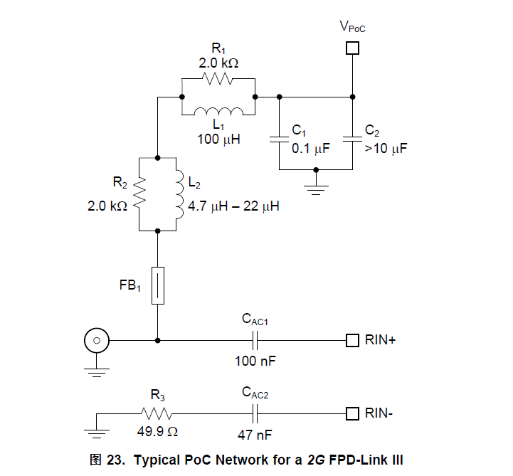

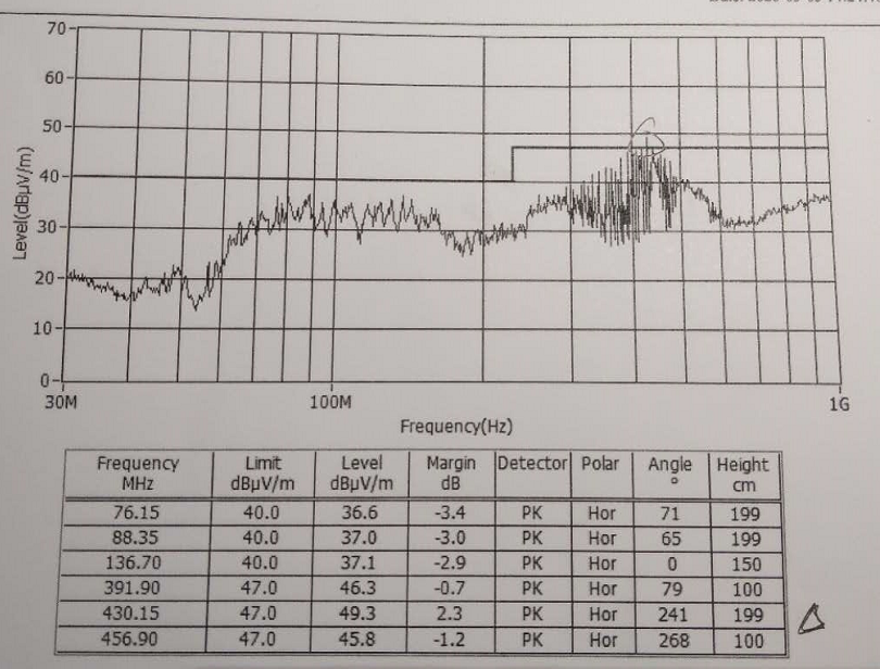

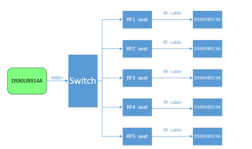

hi  team
          I use the DS90UB914A and DS90UB913A,and I had fellow the“An EMC_EMI system-design and testing methodology for FPD-Link III SerDes.pdf” design my system,but there are also have the the RE issue,at the 430MHZ,it over the class B limit。how to fix this issue? The circuit set as fellow
