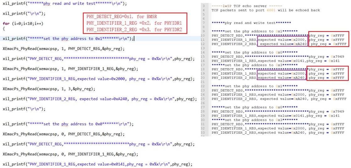

I met an issue when test ethernet with 10/100M PHY DP83822IRHB.
  1. There are three PHYs separately  connected to three  GEMs of the CPU via RGMII.The All the PHYs share the same MDC/MDIO serial management interface.
  2. It is failed to read phy address for ETH0 and ETH1 whiling using lwip echo server test which looks up phy address from 31 to 0.
  3. It is failed to read phy register when I set the phy address to 0x1 or 0x3 in SW.
I’m not sure what happens during phy read operation. Is there any other action should I take before phy setup?

    1. Other than 3 822 phys of target address 0x01, 0x02, 0x03, are there other devices also connected to the MDC/MDIO bus?

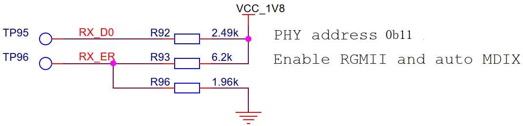

    2.   fMDC≈1/(2.26us)=454KHz according to the Oscilloscope. It is smaller than the fmax (25MHz) and also smaller than the typical frequency(2.5MHZ). It is NOT continuous.
    3.   For phy id 0x1, no external strap resistor is added . For phy id 0x3, a RH=2.49K is added to set the phy_addr[1] as ‘1’
