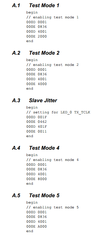

Hi team,
May I ask why there is no test mode 3 in this application report? Is Slave Jitter equal to test mode 3?
Hi team,
Hi Amelie,
In IEEE Std 802.3bw, Section 96.5.2 defines only Test Mode 1, Test Mode 2, Test Mode 4, and Test Mode 5. There is no definition for Test Mode 3.
Thank you,
Nikhil
