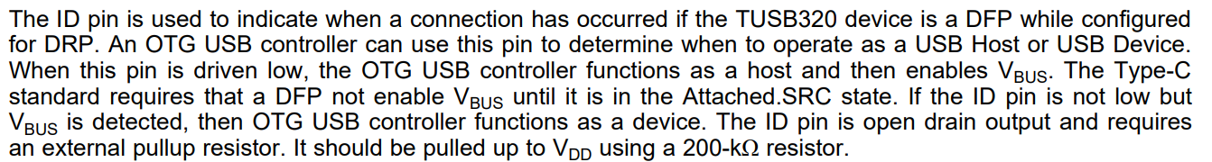

my customer is using TUSB320 as solution , and they wanted to ask , since the port role can also be detected by I2C register ,
can it left ID floating if not used?

if you don't use ID pin, you can just left it floating.
