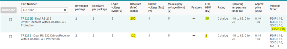

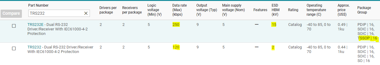

what is the difference between trs232 and trs232e?
what does 'e' stand for in trs232e?
Hi Pushpak,
I believe the main difference between these two parts is their ESD rating. TRS232E has a much higher rating at 15kv HBM and specifies ratings for contact and air-gap discharge. It also appears that TRS232E has extra packaging options.
Note that TRS202E is the 120kbps version of TRS232E.
Let me know if this answers your question or if you'd like to know anything else about these parts.
