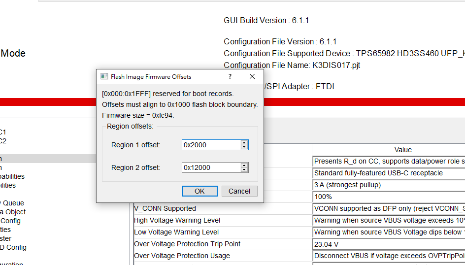

    My customer had a problem migrating from version 3.10 to 6.11.
    They try to fill in the configuration setting to 6.11 based on the pjt file(version 3.10) from version 3.10 and then generate a new pjf file(version 6.11).
    But it failed to configure TPS65982 from K3DIS017.pjt.
    They found that when saving the file in version 6.1.1 there is one more offset need to be filled in (Region 2 offset).
     Would you mind give us some clues about setting this? I am not sure whether I can share the the project file on E2E or not.

  • Hello Edward,
    When creating a new project file within the v6.1.1, open one of the default templates, and then update the relevant fields using your v3.10 project as reference. Then, when generating a binary image, click okay for the default offset that pops up.
