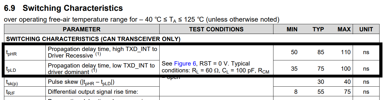

Customer has a requirement on: Node internal delay time” The Max internal delay time in an ECU shall not exceeds 350 ns, is this just the spec as below? If yes, what's the maximum number? Thanks.

    Could you define what the customer specifies as internal delay time? Is this the time between the send command being sent to the beginning of the message?

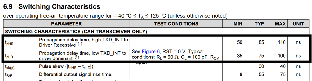

    The values in this section refer to the propagation delays of the CAN transceiver only and do not account for controller timings. If this is what the customer is interested in, the Min/Typ/Max is defined in section 6.9 of the latest datasheet (Draft screenshot removed).
    Eric

    Thanks. This is just what I want.
