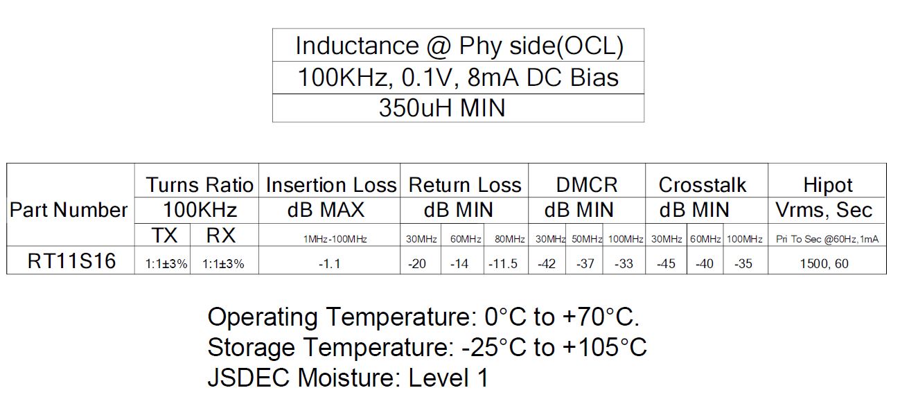

Hi team.
My customer want to use the pulse transformer is RT11S16(CHOKE COILS TECHNOLOGY CO.,LTD).
This is its spec.
How do you think about this spec?
I'd like to know it can be used without any problems.
(*Of course, we ask our customers to evaluate on devices.)
Sincerely.
Kengo.
  • Hi Kengo,
    This part has a turns ratio tolerance of 3%, recommended is 2% tolerance. In section 10.3.1 of the datasheet we have recommended transformers and transformer electrical specs. If the customer is happy with their evaluation, then this is ok.
    Thank you,
    Nikhil
