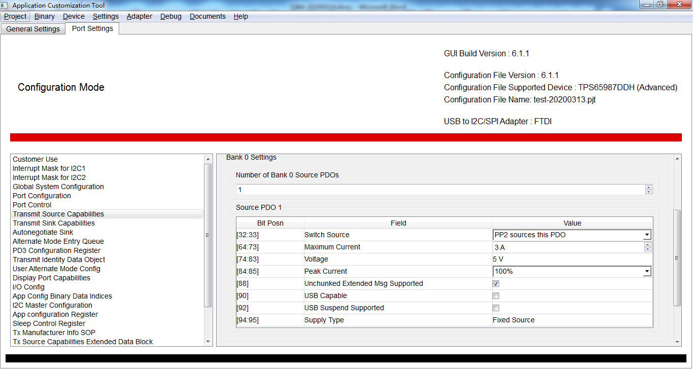

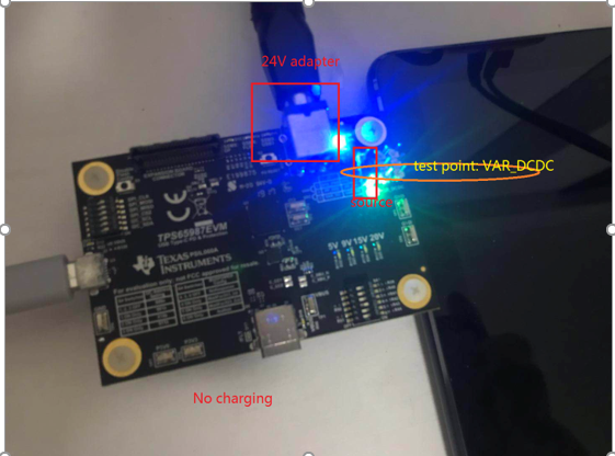

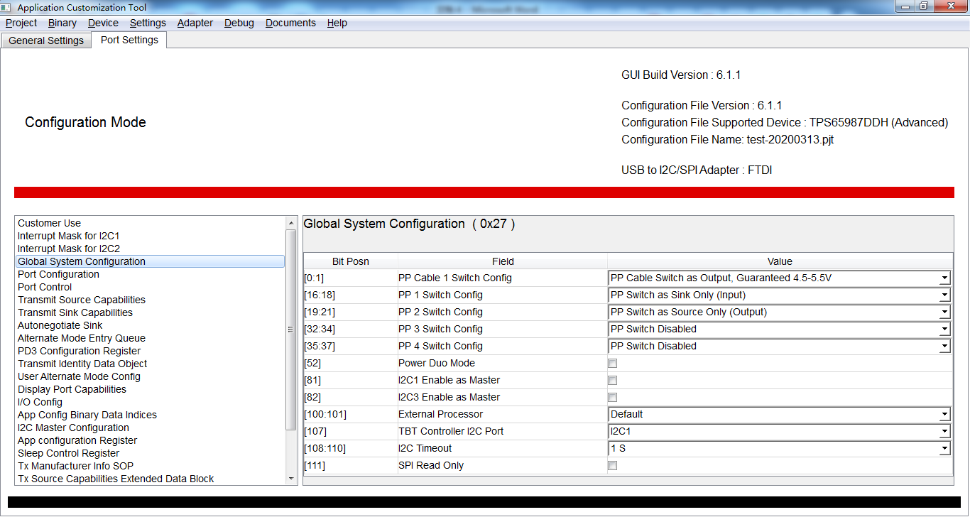

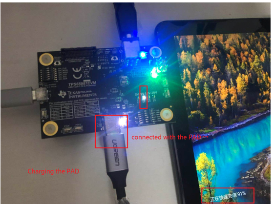

  • 1) The TPS65987 worked as source when charging the device. The configuration was as follows:
    2) As shown in the picture, we used a 24 adapter to supply power. When the PAD wasn't connected with the EVM, the test point voltage of VAR_DCDC was 5V. While once the PAD connected, the test point voltage of VAR_DCDC became 5V, and the PAD showed that it was in the fast charging mode which was not the same as expected.
    3) What we need to do is that integrate the TPS65987 circuit on the circuit board and use a 5V adapter to supply power. Can this be achieved?

    I believe you had a typo in your previous post for item 2. Below I highlighted what I believe you meant to say
    • As shown in the picture, we used a 24 adapter to supply power. When the PAD wasn't connected with the EVM, the test point voltage of VAR_DCDC was 5V. While once the PAD connected, the test point voltage of VAR_DCDC became 5V 9V, and the PAD showed that it was in the fast charging mode which was not the same as expected
    If you are seeing the DCDC change from 5V to 9V once the PAD is connected to the type-C port, then this is expected behavior. The EVM has the capability of supplying 5V, 9V, 15V, and 20V by default. The TPS65987DEVM will advertise these source capabilities to anything connected to its Type-C port, which in this example is the PAD. The PAD will see these source capabilities, and request a voltage that the EVM is capable of supplying which in this case is 9V. The TPS65987DEVM will receive the request, and then change the DCDC to output 9V instead of 5V.
    If you want the TPS65987DEVM to output only 5V, then you must change the source capabilities of the EVM using the Application Configuration tool. At the bottom of the webpage are some tutorial videos that can help you get started.
