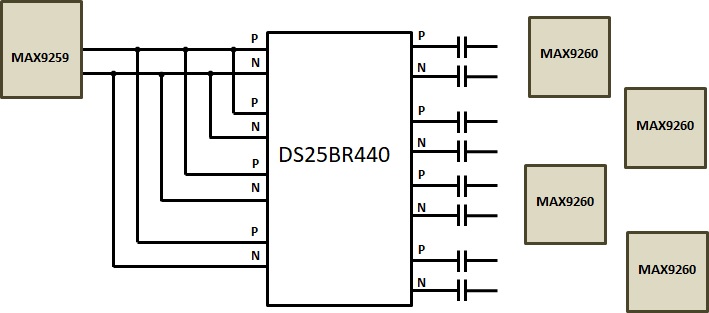

I would like to verify if it's workable to use DS25BR440 to distribute MAX9295 output LVDS signal into 4 output?
Alex

Hi Alex,
This may work for low speed signals. I would recommend to use the DS25CP104A to perform the 1:4 operation internally. This allows a much higher bandwidth path through to the 4 destinations.
Lee
