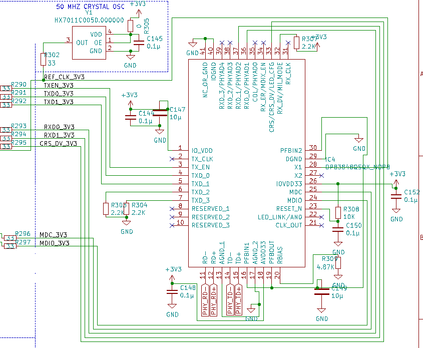

Here is the schematic for the phy:

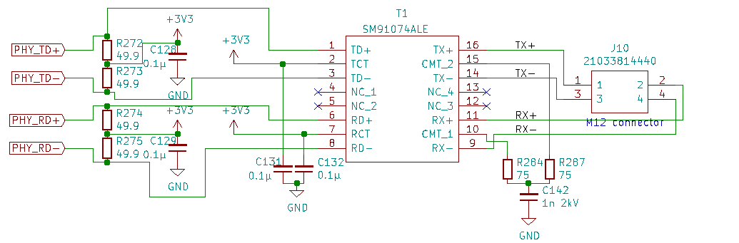

Here is the schematic for the magnetics and the connector

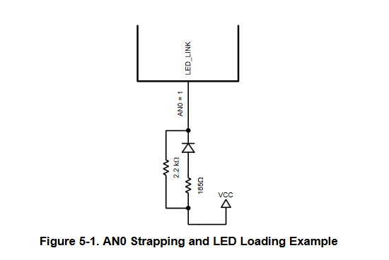

I soldered an LED to AN0 pin according to datasheet for debugging the linking.
This does not affect my autonegotiation strapping, since AN0 pin is set to 1 by default. In my case its unconnected.
When install jumpers from TX+ to RX+ and TX- to RX- on the M12 connector ( external loopback), and the LED turns on, indicating that link is established.
When i connect the board to my laptop with profibus cable and RJ45 crossover adapter, the link is not established. The led wont turn on, and the ethernet adapter says cable unplugged.

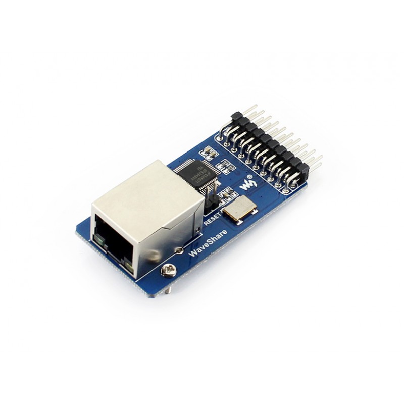

I also have one of these waveshare DP83848I modules. When i give power to this, and connect this to my laptop i get link instanty. With or without crossover adapter.
Here is a schematic for this module.
DP83848-Ethernet-Board-Schematic.pdf
I can take measurements from this, if needed.

  • I measured the voltage on RBias, it was at 1.18v.
    Also measured voltage at PFBOut, voltage was 1.72v
    Measurements were done with board powered up, nothing connected to M12 connector.
    Also measured that the voltage at 3.3V power supply rail does not dip, supply does't seem to be the issue.

    The schematic is correct, and the layout is otherwise OK, but the 49.9 ohm resistors are placed near the transformer, not close to PHY.
    I am not using RJ45 connector, and the unused pairs on the cable can not be terminated thru 75 ohm resistors.

    VDD pins have 0.1µ ceramic SMD capacitors near pads, and there is one 10µ bulk capacitor at 3.3V close to phy. No 0 ohm resitostors or ferrite beads.
    Power Feedback Supply
    This seems to be the biggest difference in my design.  I only have one 10µ ceramic capasitor and the 0.1µ capacitors are missing. I should change the 10µ cap to tantalum as recommended, and add 0.1µ caps for PFBOUT, PFBIN1 and PFBIN2
    RMII
    Series resistors in my designs RMII lines are 33 ohm, and the recommended is 50 ohm.  Traces are length matched. This is not the issue in my case, this should not affect linking.
    External oscillator
    In my design there is no pulldown resistor after series resistor.

    Magnetics
    Transformer i have used is not in the recommended list. Good thing is that there was listed transformer that can be used with same footprint.
