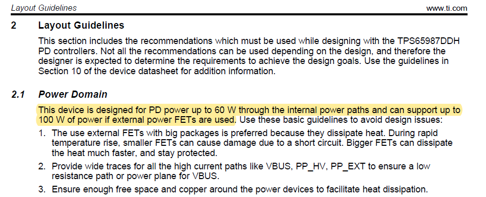

  • Hi Adam,
    Customer system requirement is of 100W power support from PD controller with internal FETs only.
    However "USB_PD_HW design guidelines document (SLVA888B)" mentions that internal FETs can support only 60W power. Please refer below snapshot for the same,
    So, is this correct? Does internal FETs can't support 100W power? Do they need to use external FETs?
    Please confirm the same ASAP.
    Mitesh
  • Hi Adam,
    Their system requirement is of 100W power support from PD controller with internal FETs only.
    Mitesh
  • Hello Mitesh,
    You can use the internal FETs for a 100W system, but they were designed for 60W applications. With that much power, in the event of a short circuit, the FETs could be damaged due to temperature rise of the die. This section is just advocating these concerns for power design.
    If this system is a sink only application, you could implement the power duo functionality which closes both internal power paths at the same time, allowing you to use both power paths in parallel. This reduces the amount of current going through one path at a time and can withstand the 100W system
