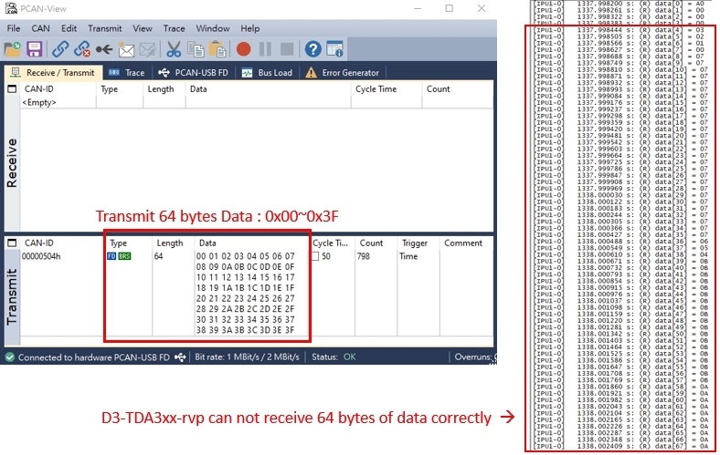

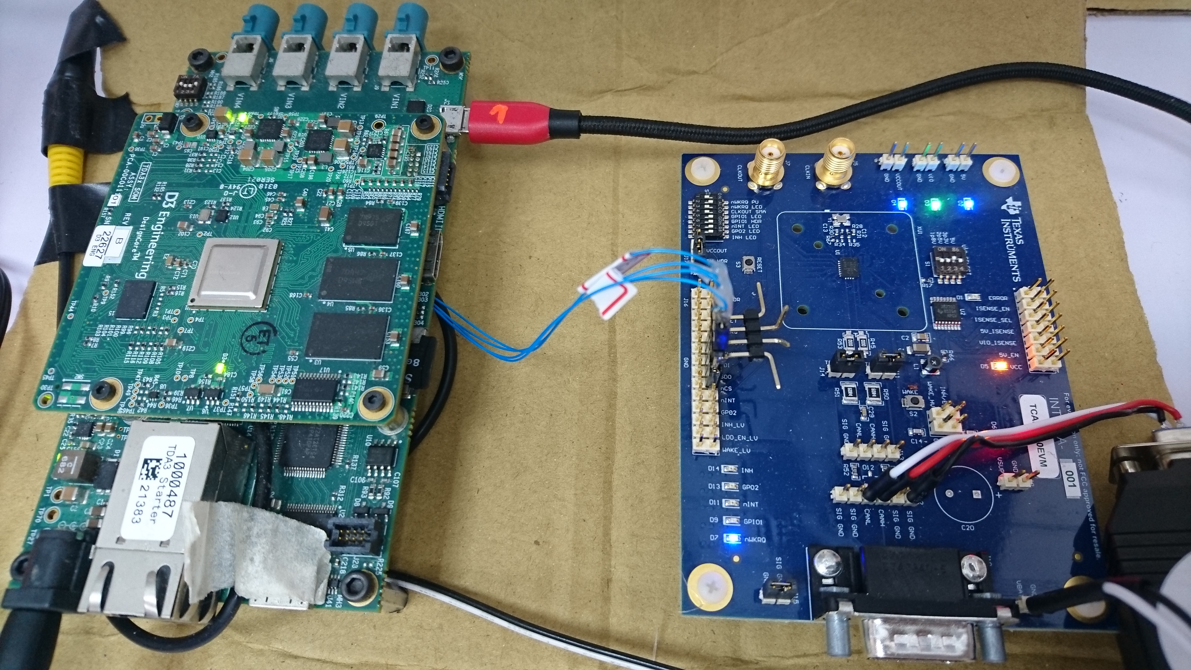

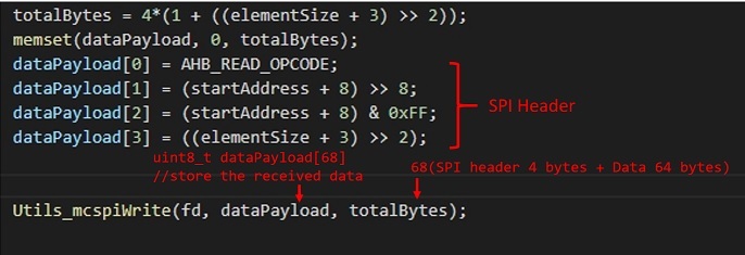

On D3-TDA3xx-rvp, I used TI provided "Utils_mcspiWrite()" function in VisionSDK 03.07.00 to send SPI command to TCAN4550EVM and tried to receive 64 bytes CAN FD data.

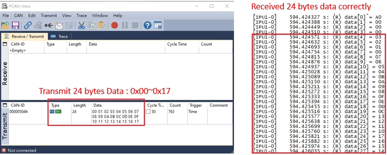

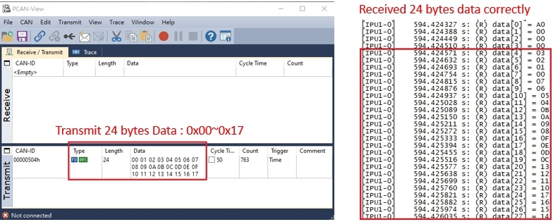

I have tried that 24 bytes data length is okay.
However, data with length higher than 24 bytes seems not correct.

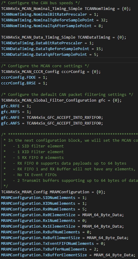

The following is my configuration.
Could you help me solve this problem, please?
Ethan

4. CAN FD receiving test for 24 bytes

  • Hi Ethan,
    How are you polling for the Received data?  I see that your byte value pattern is continued throughout the total data log where each 4 byte word of data  is received in inverted order.  By that I mean that your expected pattern would be:
    [03,02,01,00] [07,06, 05, 04] [0B, 0A, 09, 08] ...
    I see in your data log that the first word is received with each byte is returned in a single sample.  However, the first byte of the second word is 07 and is returned for 28 samples in the log with a total time stamp delta between the 00 and final 07 value equal to 2mS.  Most samples are 61uS apart with a couple being 91uS, 92uS and 122uS.  But then the next expected data value of 06 is returned, followed by 05, and then 04 each with a single sample to complete the second word of data.
    Then the beginning byte of the third word is once again stuck for multiple samples (19 samples) with a time stamp delta between the final 04 byte and the final 0B byte of 1mS.  However unlike the second word, the second byte of the third word is 0A and it too gets stuck for multiple samples in the log with unknown length since the log ends before the next value received.
    The fact that the data values are in the correct order leads me to believe that they are probably being received correctly by the TCAN4550 and are placed in the MRAM memory correctly.  And I suspect there is some problem with the SPI reading of the returned data values into your data log.
    Can you continue to read the data beyond the 67 bytes you are currently running to determine if the pattern continues and that all the data is actually returned eventually?  Also, I would be curious to know if there is some pattern to the time stamp delta between the stuck bits that might lead to some other process happening in the processor that is causing a disruption to this data read such as another interrupt, etc.
    Have you manually tried to read the MRAM values directly to verify the contents of the memory allocated for the RX data?
    Since the first stuck byte seems to be the first byte of a word, can you check the code to verify how subsequent words are handled by the SPI read to ensure there aren't any memory overlaps, or other issues with how that code works for multiple word reads.
    Also, are you reading the data with single word SPI reads, or multiple word SPI reads?
    Jonathan
  • Hi Jonathan,
    I modified Utils_mcspiWrite() function to send SPI Header and read data with Multi-word.
    Received data is stored in dataPayload.
    Ethan

  • Hi Ethan,
    Are you seeing any errors while transmitting from PCAN and while receiving on TCAN? Also, your MCAN message RAM configurations look fine.

  • Hi Vivek,
    I didn't see any error messages while transmitting and receiving.
    I have tried single-word method to receive 64 bytes data, and it works.
    But I don't know why multi-word method can't get the right result.
    Ethan

  • We have some additional information to share on this thread.
    Are you still facing this issue or it is resolved?
    below is my understanding about the setup, let me know if it is correct.
    TDA3xx is connected to TCAN using SPI interface. TCAN is connected to external CAN device (PCAN).
    TCAN receives the data over CAN interface from external device (PCAN)
    TCAN sends the data to TDA3xx through SPI interface.
    Currently the data received from external CAN device PCAN is verified at TCAN message ram.
    The issue is seen when receiving the data at TDA3xx through SPI in burst mode only.
    How is the SPI configured? What is the frequency of the data transfer?
    What is the difference in the SPI configuration between the working and on working case?
    Please share the difference in APIs/Parameters and the SPI register setting
    Prasad
  • Hi Prasad,
    This issue has been resolved by decreasing SPI clock speed(18MHz--->8MHz).
    Thanks for your help.
