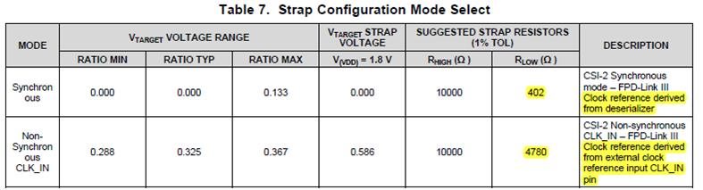

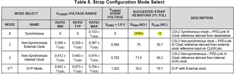

Hi Team,
Please see below Mode setting to DS90UB953 with Rhigh and Rlow.
The setting was changed from SNLS552 to SNLS552B.
Our current design use Synchronous mode as SNLS552 configuration Rhigh=10K and Rlow=402.
Does this cause any problem if we don't change to SNLS552B Rhigh=open and Rlow=10K.
SNLS552 –SEPTEMBER 2017
SNLS552B –SEPTEMBER 2017–REVISED SEPTEMBER 2018
