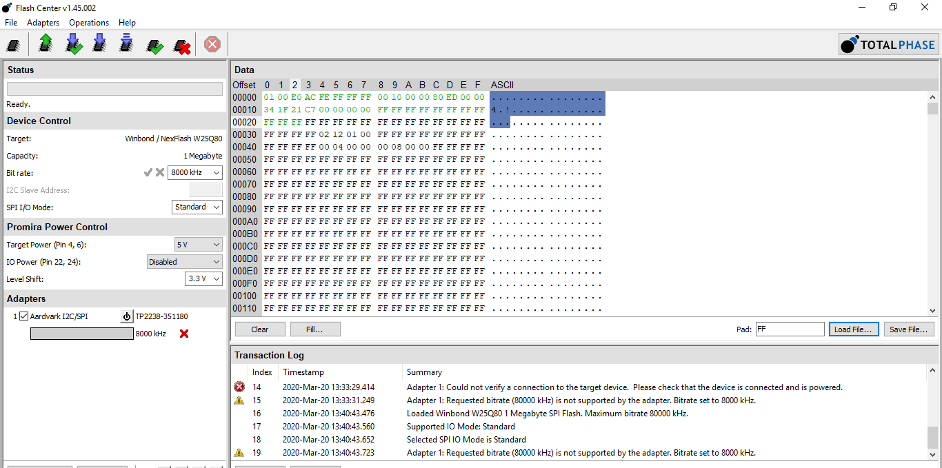

I used TPS65982 config tool to generate the image to update the firmware to the TPS65982's SPI flash.
Attaching the image for the review.
Please review the image and let me know if everything is correct.
the issue is the TPS65982 on my board negotiates with Type-C PD sources at 5V only most of the times, and only in some cases it negotiates for 12/15/20V profiles.
